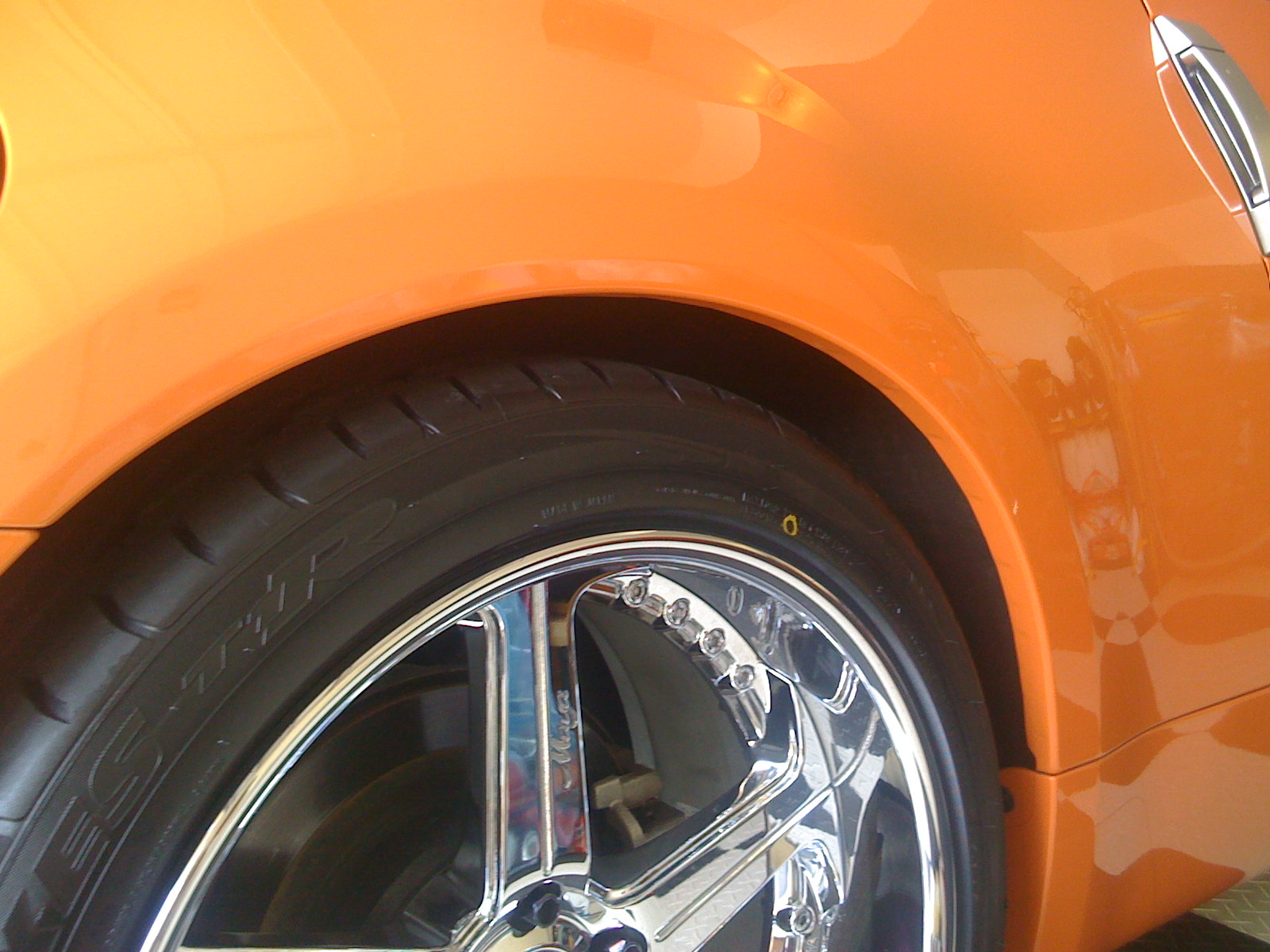

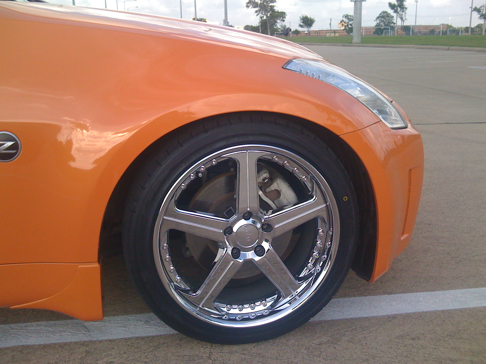

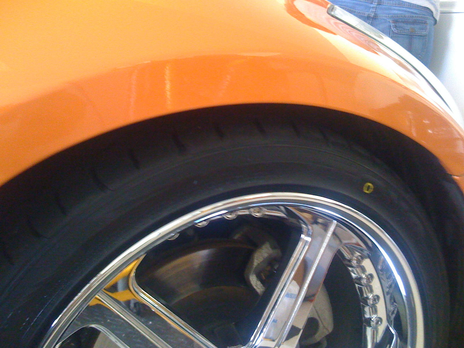

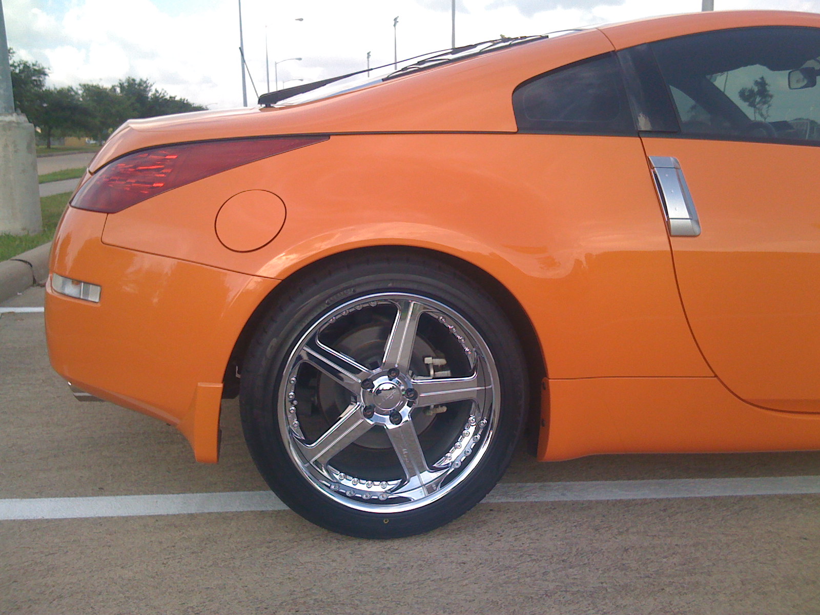

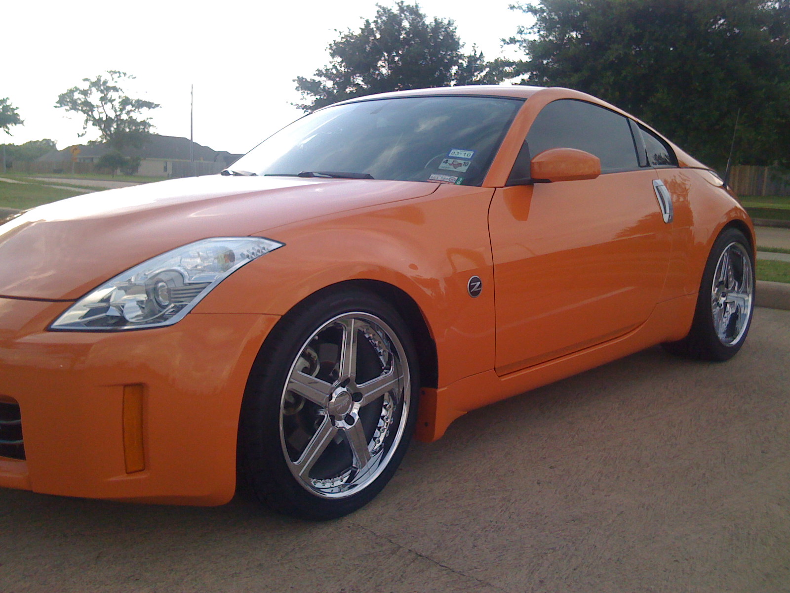

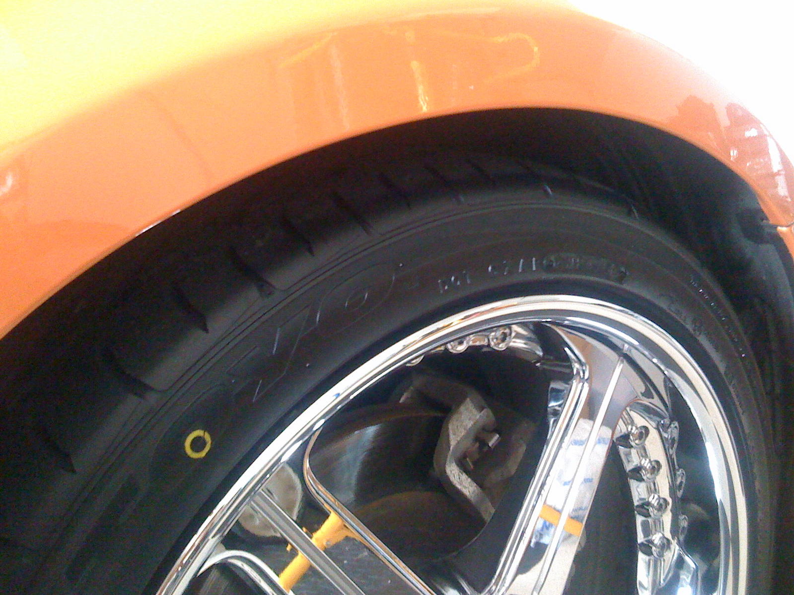

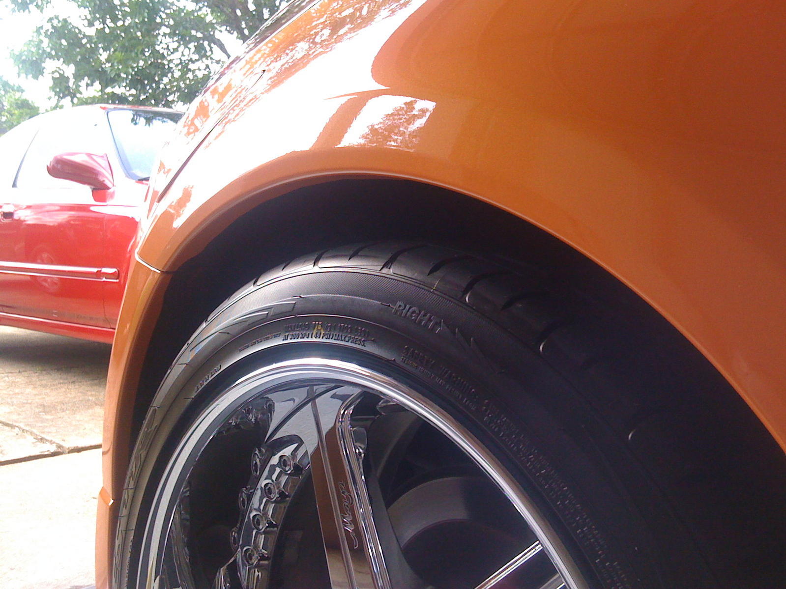

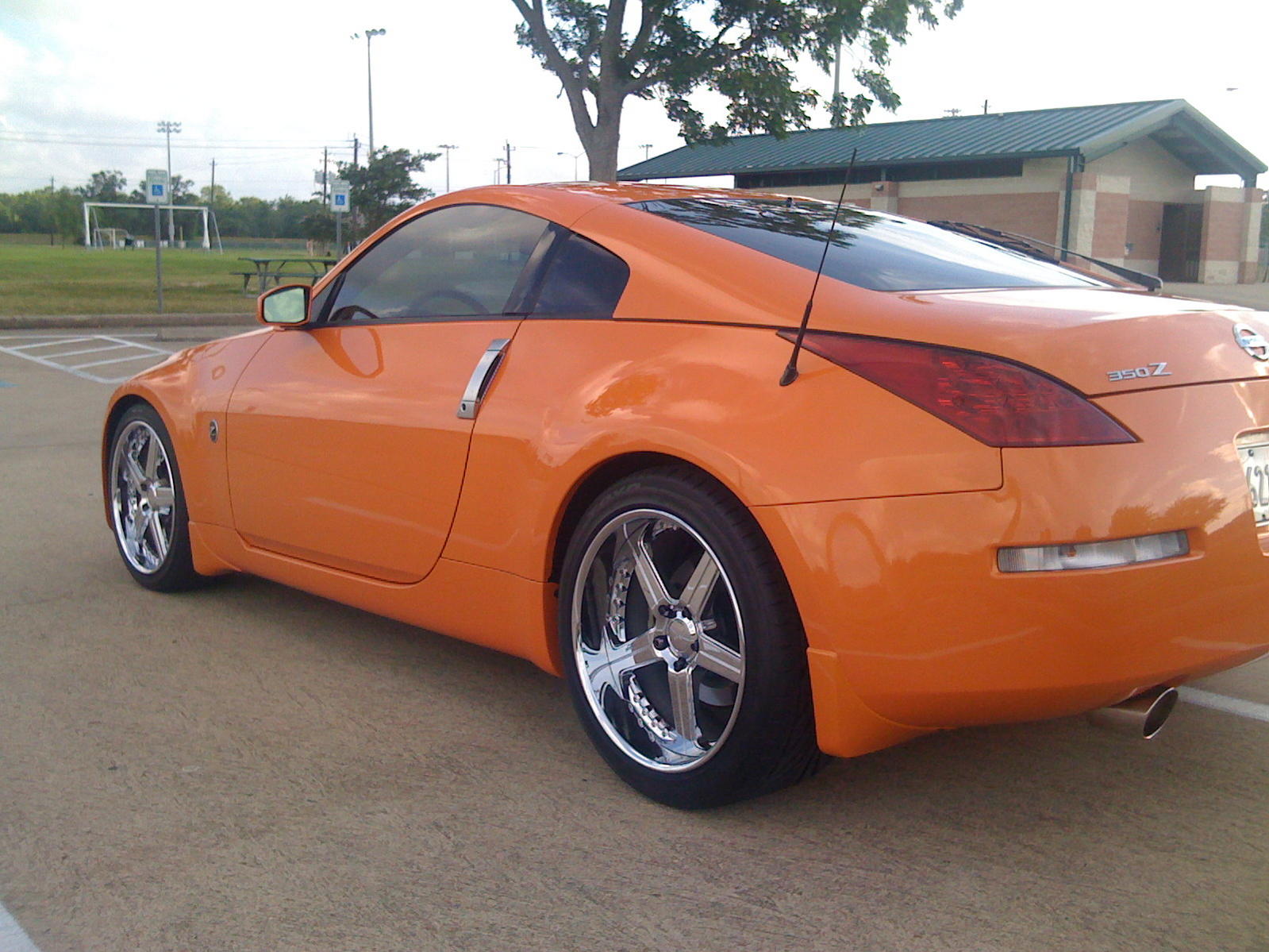

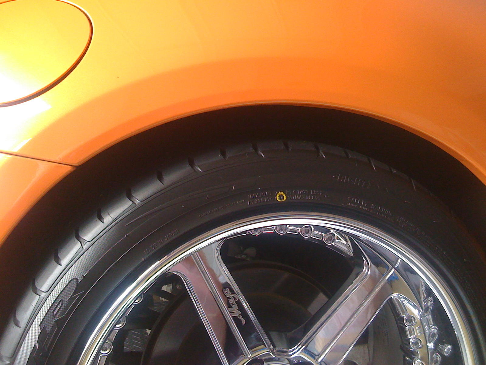

Well finally got everything done..... Lil bit of problems here and there but overall I'm pretty happy with the outcome. Well again I've got 19" Maya RT5's with Toyo T1R's 255/35/19F & 285/35/19R dropped with Tein H-Tech springs. Thought I could get the TPMS on the rims but no success and also thought I'd need the rear camber kit with toe bolts but nope I didn't. Told me there are plenty of adjustment left on the stock ones so no need to add those. Anyways here's some pics hope yall enjoy!!

Of course you don't need a rear camber kit with toe bolts look how damn high your car still sits. Drop it more and then tell me you don't need a rear camber kit with toe bolts after your tire's wear out by going down the street a couple of blocks..haha. Your car needs to be dropped more...my opinion. Wheels look nice though but not a big fan of chrome.

Guess I just kept getting mixed advice some told me I'd need them and some didn't think I'd need them but I guess I'm better safe than sorry. I'll drop it more maybe later but I like were its sitting for now. I'd like to get coilovers down the road but at least with this drop it shouldn't destroy my stock struts since its not a huge drop.

Damn I screwed up!! The second set of pics are the before hahahah!! My bad and so is the one in the 1st post with the red car behind it. Sorry guys got the pics mixed up.

Once your fenders hugs your tires you will need a camber kit immediately for the rear. So, if you plan on dropping it more make sure you get the camber kit first. Otherwise you will be going through rear tires like crazy....talking from experience. Hope this advise helps you out.
