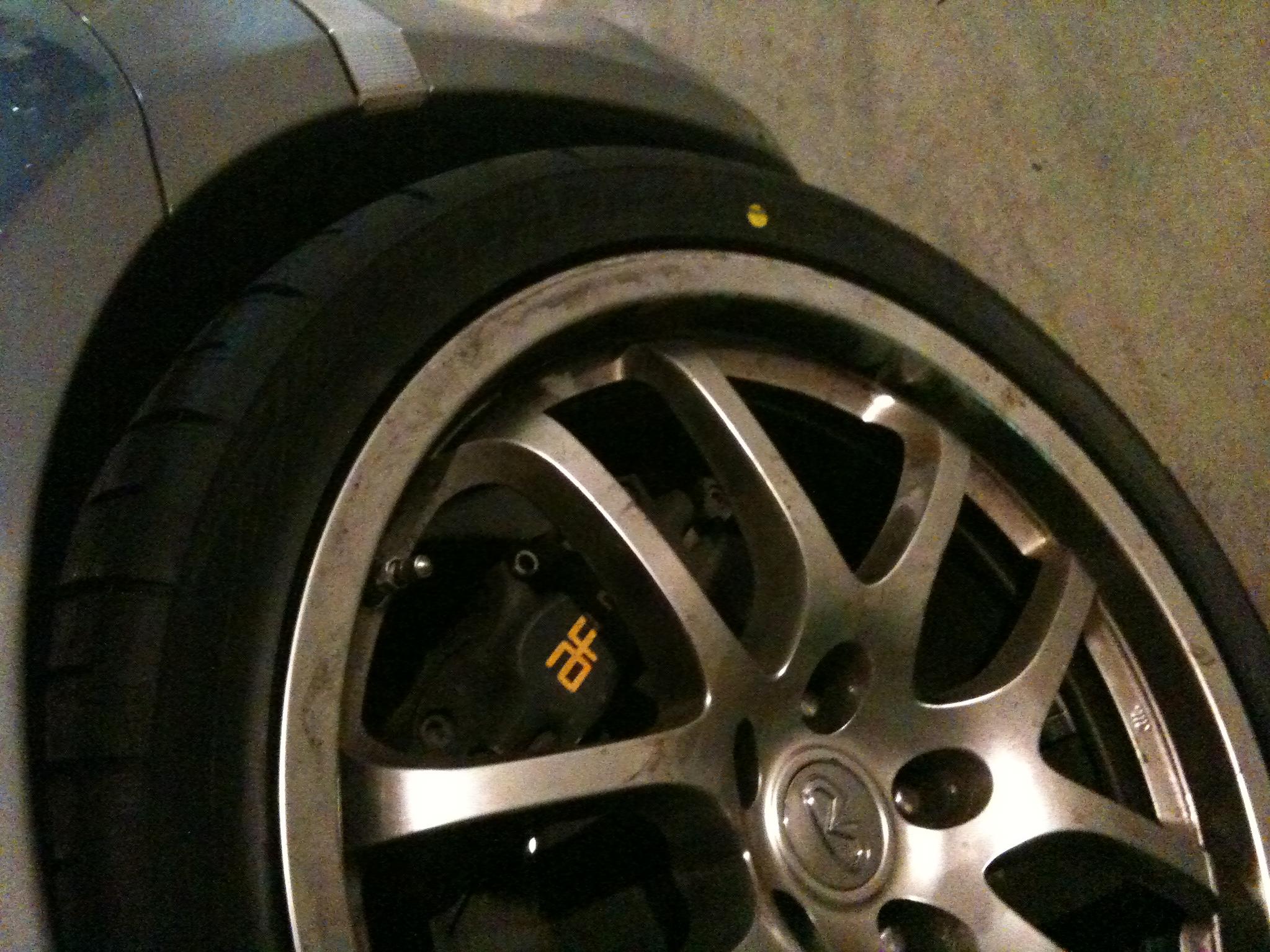

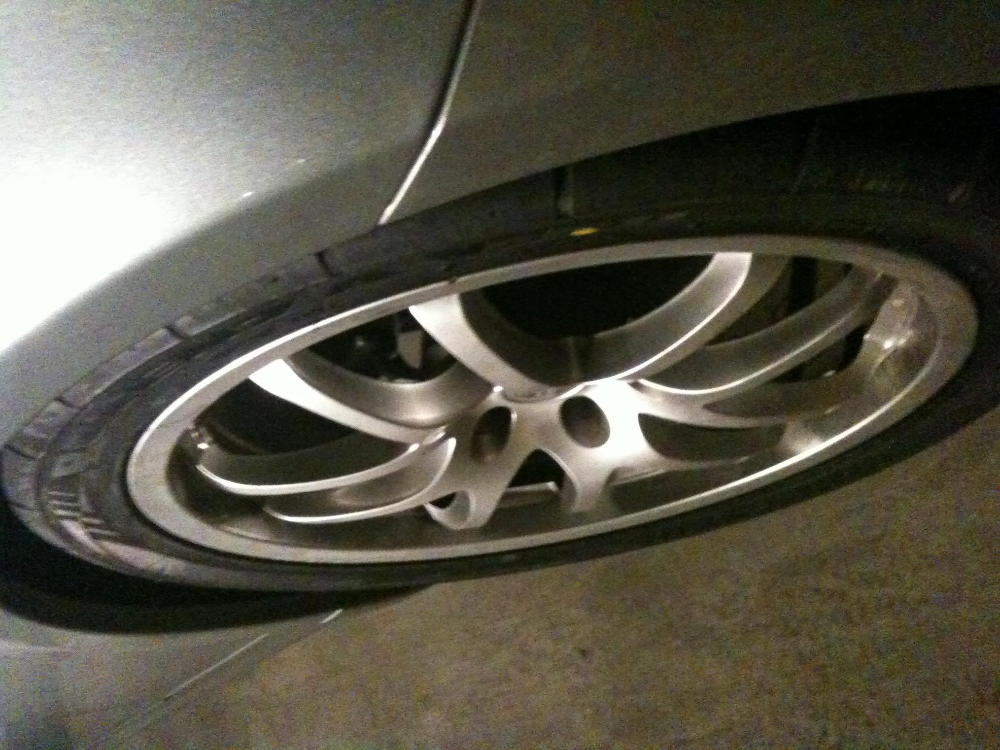

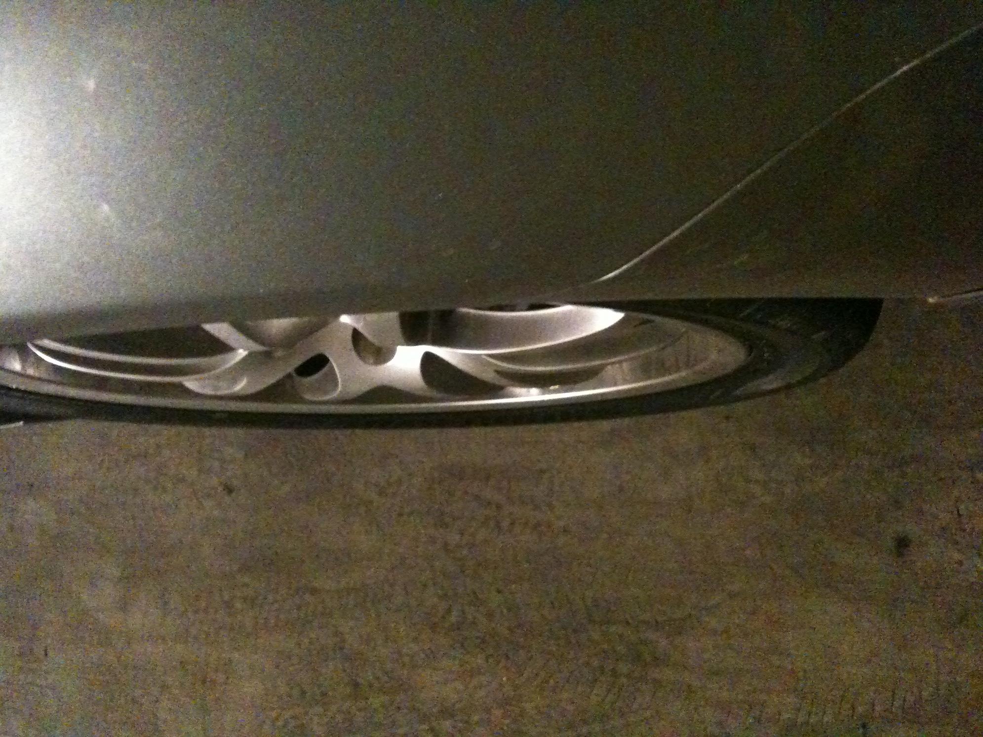

Old Sep 18, 2009 | 01:53 PM
terps's Avatar
terps
Posts: 898
From: Washington D.C.
^pshh check it out they are fine. sorry for poor quality photos done on iphone

You're not getting it. Sure you can squeeze a 285 or even 295 tire on a 8" stock wheel. We do it all the time for autocrossing. That's not to say it's the best setup for the street and everyday driving. The manufacturers recommended largest tires on 8" wide wheels is a 255, and on 8½" is 265. Their sizing takes into account safety, wear, ride comfort and mountability.
