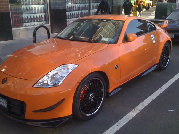

I recently got a 20X11 rims running 285 30 in the rear.. i notice is not aggressive enough .. is either i drop a inch all around or get a 20mm spacer for the Rear.. to make it come out... Which Brand would you ppls recommend ??

i say spacers concidering how bad people point it out when it isnt a good offset... It is cheap too. Then you could start saving for some good coilovers and have that nismo sitting sexily angry.

I would just ditch the wheels, usually when you upgrade wheels you don't want to go narrower than stock (you did in the front) i would also be they are heavier that stock, and the offset sucks , actually sucks bad.
