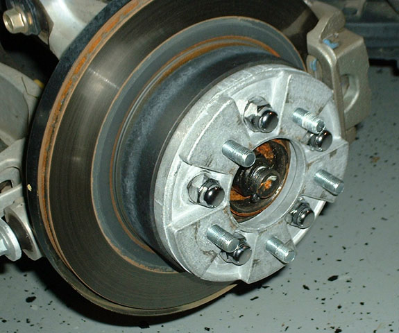

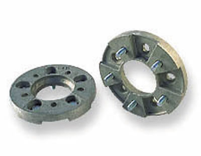

Required Items:
Spacers $39/pair
10 open end lugnuts 12x1.25mm to bolt the spacer to the car, about $10 @ pepboys
10 1/2" standard lugnuts, to bolt the wheel to the spacer, also around $10 at pepboys or summit.
The standard lugnuts I got from summit (Part SUM-753032) use the same size lug wrench as our factory lugnuts.
Old Oct 13, 2003 | 08:06 AM
2003z's Avatar
2003z
Posts: 4,959
From: Atlanta
spacer on the car (the 17" G35c came with short lugnuts, which worked with my wheels, so I didn't need the open end ones)

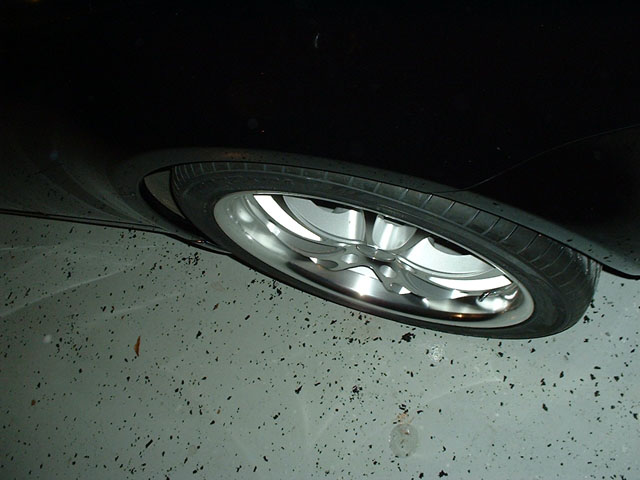

and with the wheel on the car

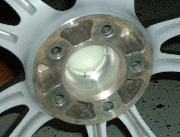

no offense taken charly, these are just an inexpensive way of doing it.
steffen, as for the stock lugnuts, maybe. If you have the 17s with the short lugnuts, they should work fine. If you have 18s you can try, because there may be some relief area behind the wheels like in this photo, and they may or may not fit up in their.
