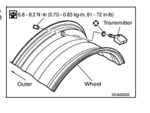

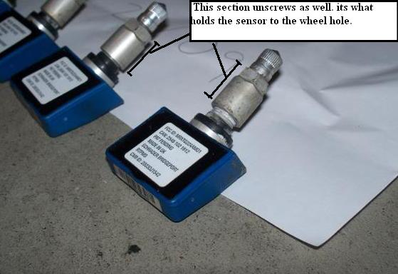

If you have never taken a tpms sensor off, the silver part unscrews and can be painted/spray painted quite easily, from there you can probably go to any autozone and get metal black valve stems.
