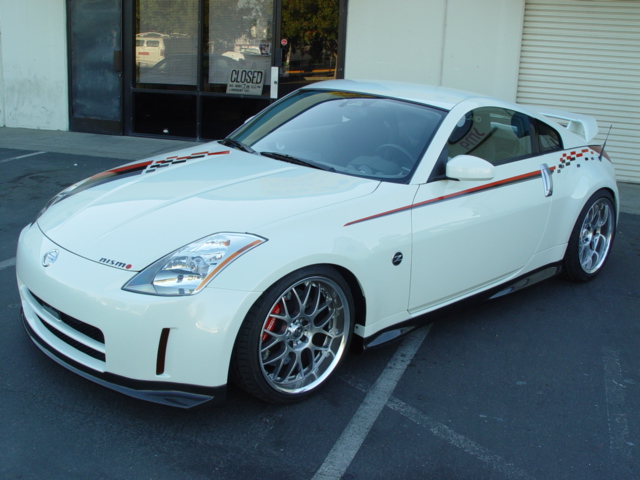

max size and offset:
front 19x9.5 19mm offset with 245/35 19"
rears 19x10.5 17mm offset with 275/35 19"
rear fenders will need to be rolled, especially if you drop the car.
this is what i have.
smaller size is:
front 19x8.5 25mm offset with 245/35 19"
rears 19x9.5 29mm offset with 275/35 19"
these sizes and offsets are from volk racing japan themselves.
