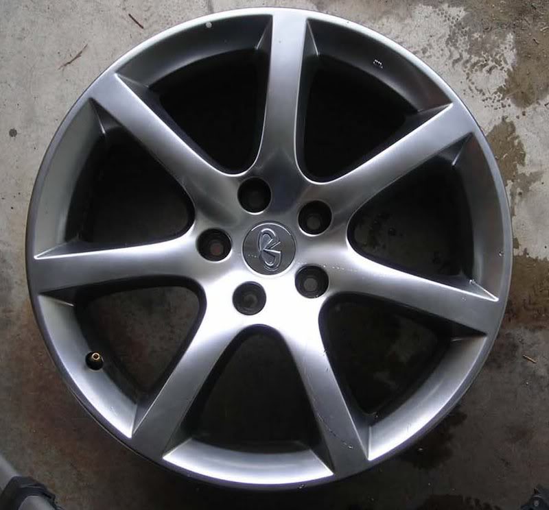

Look at the seat on the OEM wheel. Is is flat or a 60 degree taper?
Old Feb 19, 2010 | 09:32 PM
ELI350Z's Avatar
ELI350Z
Joined: Aug 2008
Posts: 47
From: MIAMI
looks like that.
got any idea b4 ill take apart the lug nut from my wheel?
Old Feb 19, 2010 | 10:41 PM
davidv's Avatar
davidv
Posts: 42,753
From: Tucson, AZ
Here is an explanation of OEM vs tuner lug nuts: http://images.google.com/imgres?imgu...26tbs%3Disch:1

"The wheels must have a tuner style 60 degree lug seating to work"
anyone know the degrees of the lug seating in the g35 coupe 18"

I use McGard Spline Drive lugs on OEM 06 wheels, and they poke out farther than the OEM lugs. They come up to the top of the lug well. I'll post pics tonight, maybe that'll help.
http://www.mcgard.com/Home/Automotiv...neDriveLugNuts
Mine the chrome lugs, between the black and the gold one in the first pic.

Ok, here's the pics I took. Was playing around with a new lens so...
http://pbckt.com/sF.dQI
Originally Posted by ELI350Z
looks like that.
That wheel looks tapered to me...
