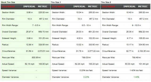

Default Squared Set Up for 9.5" wheels
Whats up guys. I just picked up a set of 9.5" wide rims. Im looking to run a squared tire set up. My understanding is that as long as the overall diameter is within +/- 3% I should not have any problems with VDC. I looked up the size difference between 255/40 and 265/40 and looks like 265/40 is the best choice right now:
225/45: 255/40 is .25% and 265/40 is 1.44%
245/45: 255/40 is -2.43% and 265/40 is -1.25%
Looking for some personal experience with this set up.
Thanks,
CJ
Thanks,
CJ
For VDC to function properly the front tire needs to be shorter than the rear. The % difference is the ratio from front to rear, compare them, vs the front to rear you want to run. 265/35 front and 265/40 rear would be a functioning square system.
