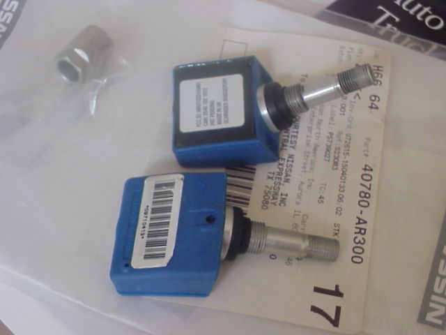

The TPSs are standard equipment on Track, Touring and Performance model US-spec Zs. See the attached photo for what they look like uninstalled. You can recognize if your car has them or not by the metal-stemmed tire valve.
Yes,, whenever you change out tires (i.e. - sensors), the car computer must be reinitialized to recognize the new sensor coded signals. Each set of four sensors must be initialized whenever they are installed on the car - otherwise you get a display of just dashes.
