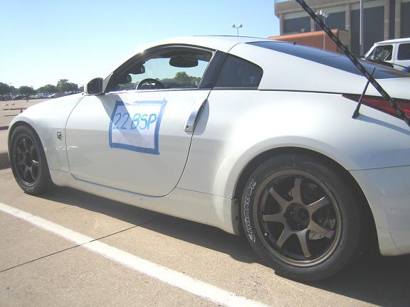

Old Apr 27, 2010 | 11:13 AM
JasonZ-YA's Avatar
JasonZ-YA
iTrader: (60)
Posts: 11,204
Likes: 32
Well right now i'v running 17x9 +17 up front with 275/40-17, -1.8 camber and had around a 1 inch drop, no rubbing
I run MB WEAPON 17X9 WHEELS.
Usually I run:
FRONT:
17x9 +27 with 275/40/17 R comps
REAR:
17x9 +17 with 275/40/17 R comps
May also see the MB Competitions...
-J
