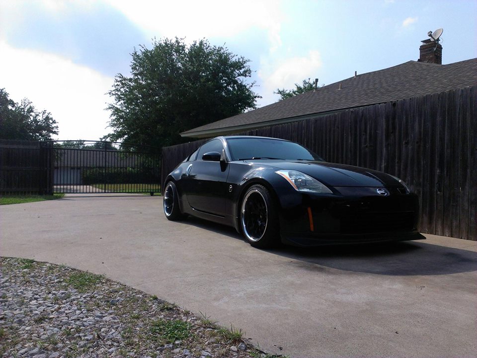

to give you some perspective, my car is on 18x10.5 +20 on all four.
an 8.75 +20 on the front would be 22 mm less to the outer edge, a 9.75 +20 on the back would be 10mm less to the outside edge. It wouldnt look too bad. Dont know about the tires sizes though, im having a hard time imagining what a 45 series would look like in my head lol.
