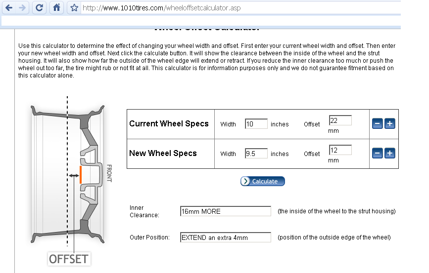

Originally Posted by Rav3n
Would the 19x10 fit the fronts? Any serious rubbing or modifications needed?
width and offset work hand and hand...
looks like the vardawgs are 4mm more aggressive in front for outer clearance.
