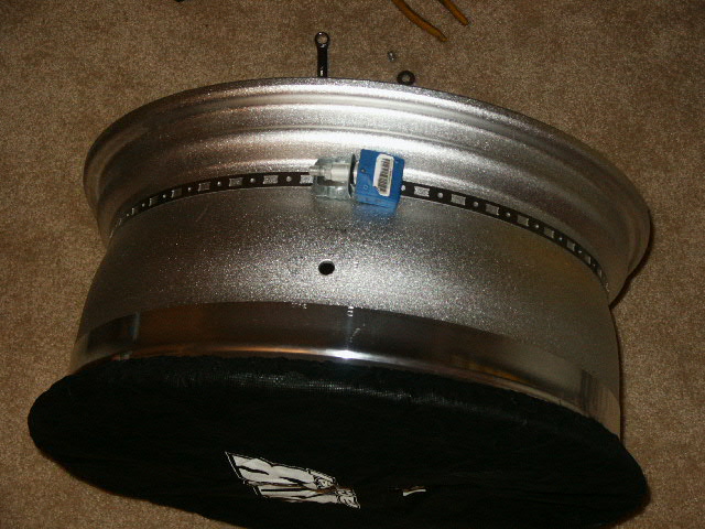

https://my350z.com/forum/showthread....threadid=30147

on the picture below from the above link that's a home made band set-up, HRE and someone else actually make a kit to do the same thing with very similar parts. The hole in the middle of the rim is where the valve stem comes out to answer that other question.
