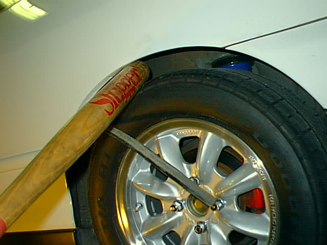

What does roll your fenders, mean?
here is a picture that kind of show you what they are talking about. You want to push that strip upward, so that the tire won't rub!
The inner lip of the fender is rolled up/ inward to allow for more clearance of the tire. In my area body shops charge between $100-$275 to do it.
Old Mar 29, 2004 | 04:34 AM
zeroday's Avatar
zeroday
Posts: 1,199
From: .
ugh...i really wouldnt do the baseball bat method unless you want your wheel well paint to start chipping off. they actually have fender rolling equipment out there...if you do this you're suposed to heat the area with a heat gun before you start rolling too.
