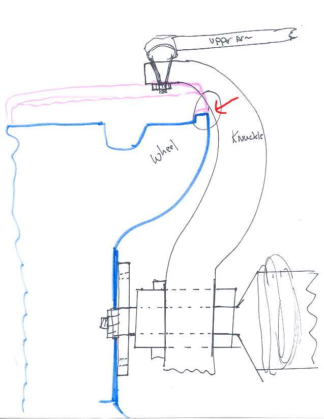

I test fit the wheels without tires about a week ago. Rears were no problem. The fronts had about 1/4" clearance between the back of the rim and the steering knuckle. Apparently you're supposed to shoot for at least and inch of clearance there? They never actually mounted the tire, he just did some measurements and said that the tire would be right up against it. It's not the bolt on the rotor... I left them a wordy note to tell them about that. He drew a picture (not to scale obviously). I hear what you guys are saying and thats why this makes no sense to me. I went a little conservative on the offset so I didn't think I'd have any problems. I think a spacer would resolve the issue... but how much?

7 mm spacer should work, but first...
Check those rim specs and be sure they are not +47 instead.. like for the 370z.

Keep in mind that everybodys favorite setup is 9½" +22 up front. Your +27 is about 5mm or ¼" closer on the inside. A 5-7mm spacer would definitely help.

Yes, I just checked the stamp on the inner barrel, +27 (O-Disk). So with a 7mm spacer netting me an offset of +20 in the front would work then? Looks like going "conservative" on the offsets actually bit me in the *** Not sure I'm feeling the idea of slip fit spacers. The Ichiba V2's only come 15mm and larger. Would the 10mm from Eibach do the trick?

Shops will often err on the side of caution. They do not want you returning complaining that the wheel is hitting the suspension. Will a 10 mm spacer fix the problem?
NOTE: Remember that the wheel clears the suspension with NO weight on the tire.
