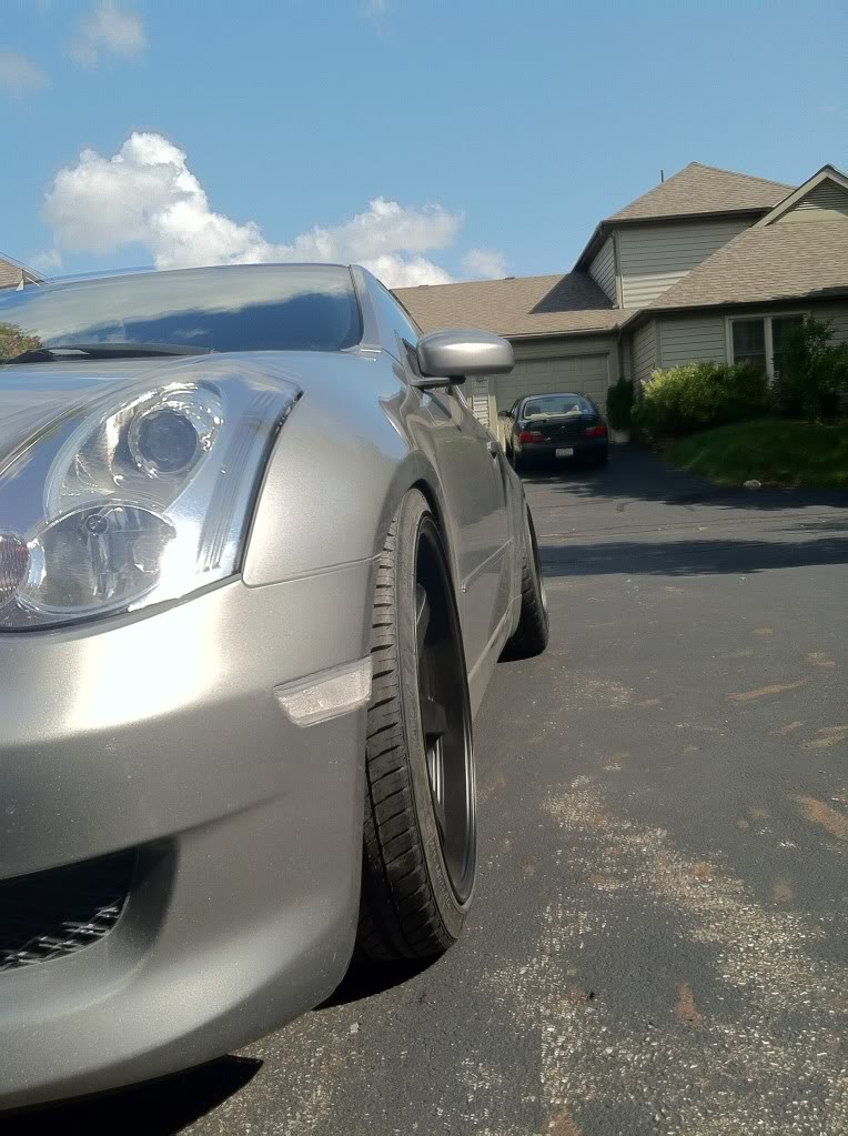

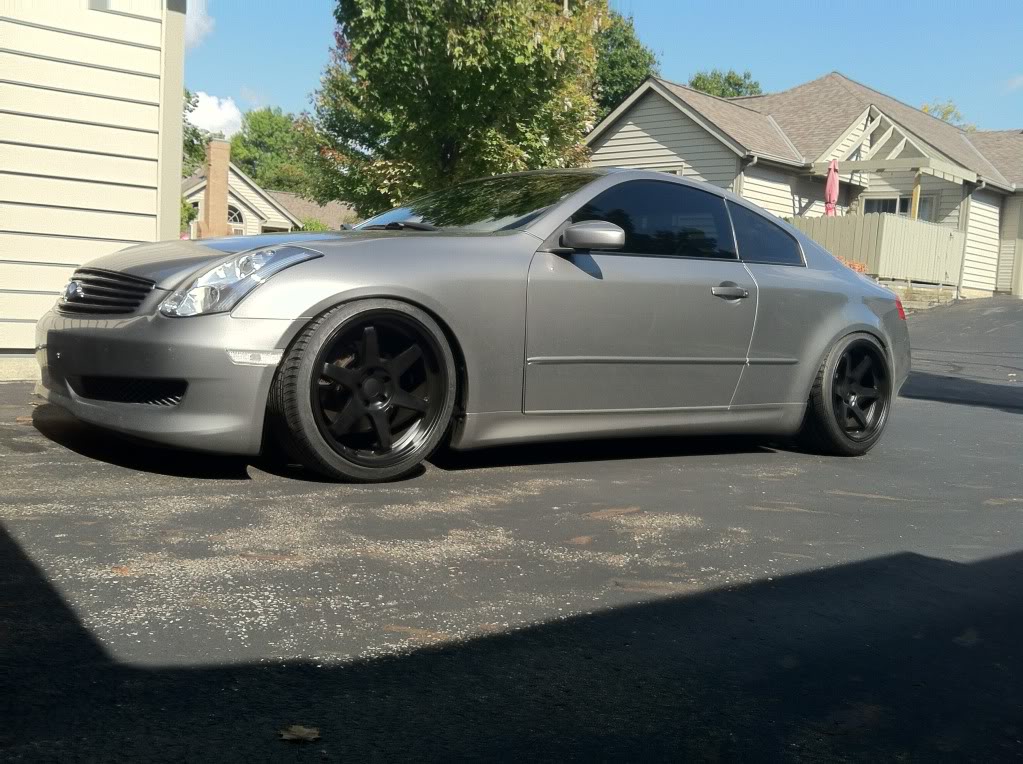

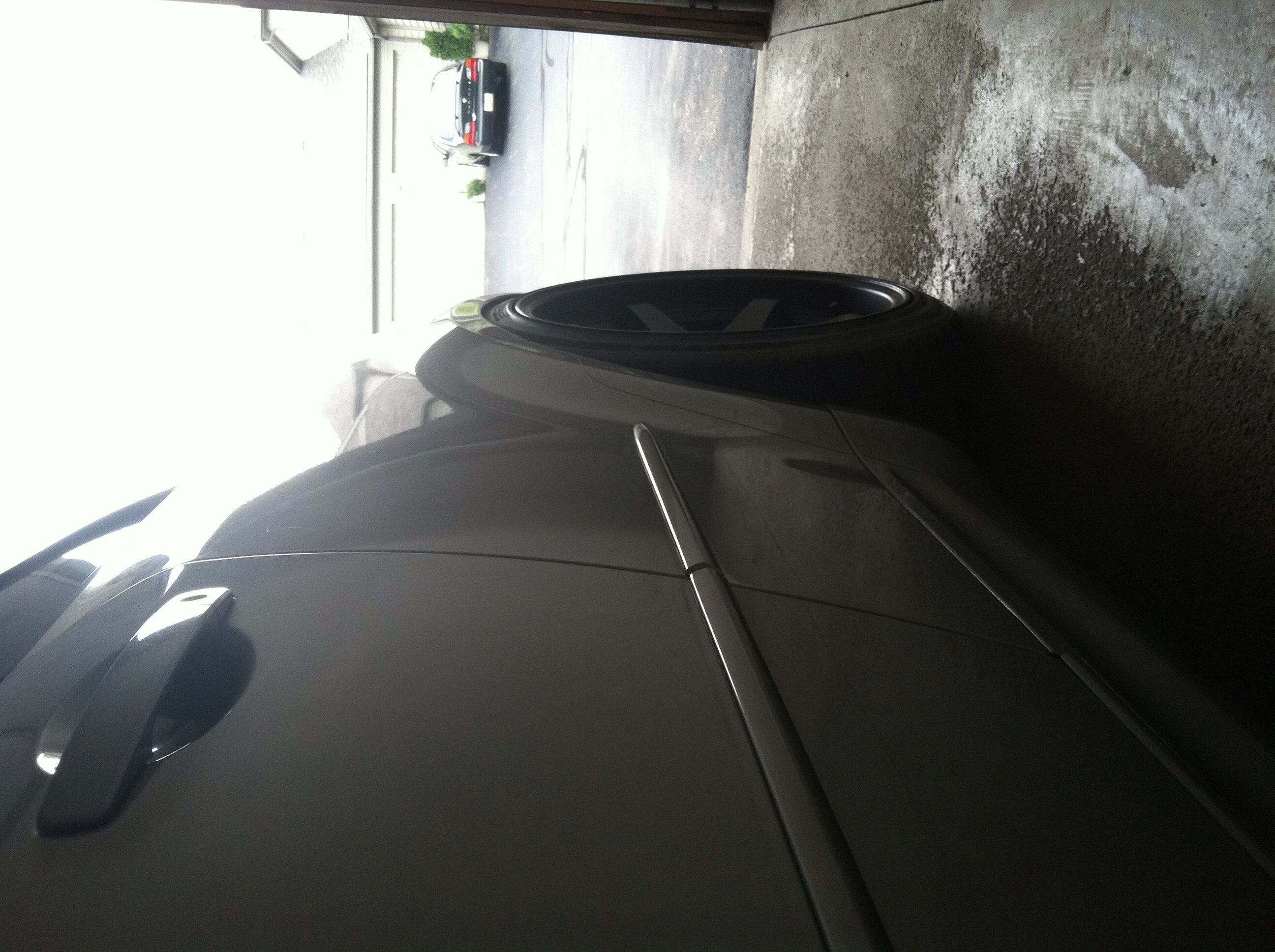

Looking for a quick response hopefully, on my g35 I have the es 2.2.2 19x9.5/11 ET 0 all around, on bc coils, spc camber kit, fenders rolled flat/slight pull. Right now I'm running 19x9.5/11 with 255/35 nankang NS-20(more like a 245 since it's narrow) and 275/35 nitto nt555 in the rear. I'm running -5.8 camber I'm the rear and still rub where the fender meets the bumper. I need to get a smaller tire in the rear so I don't rub it's chewing up the tire real bad on the outer edge.
Should I do a 255/35, 265/35 or do 275/30, tire dependent.
Here's what it looks like right now, I would like to have more stretch in the rear. Sorry for the big pics
