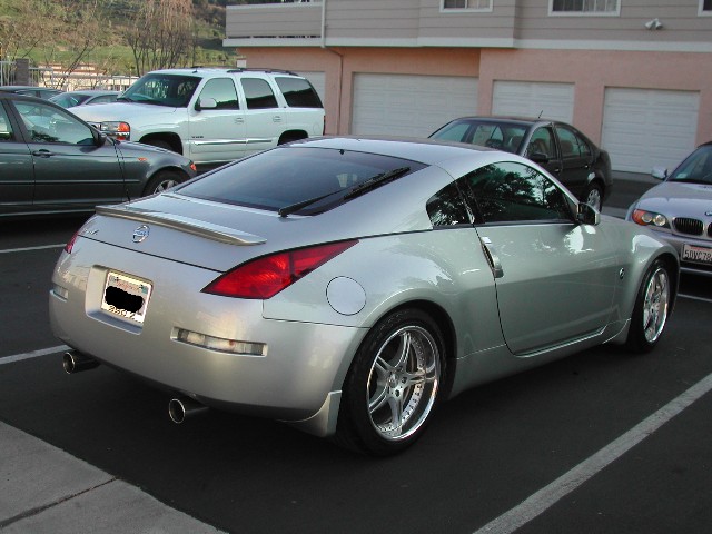

I don't have 19's but I have some 18's.
Here are some pics.

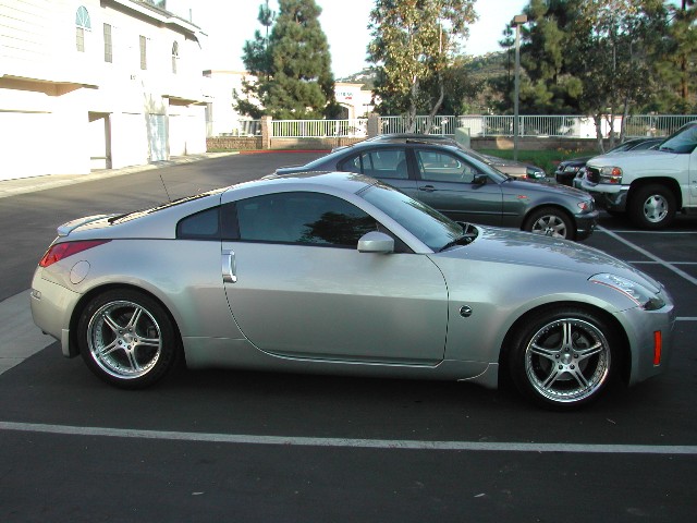

Pic#2

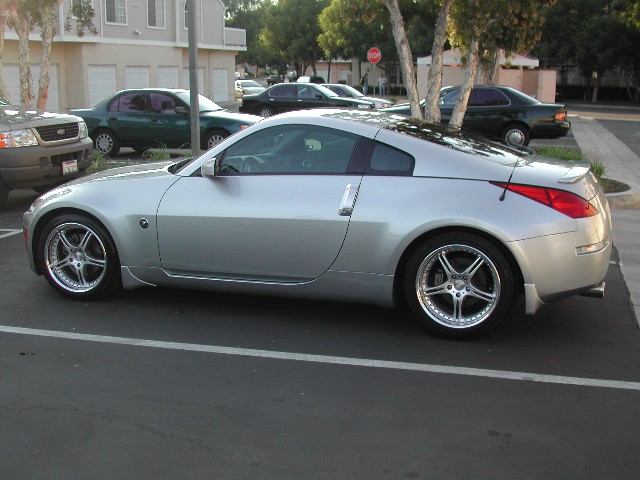

Pic#3

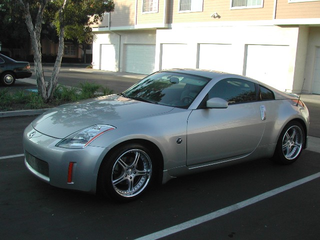

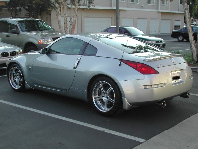

Sorry no close-up pics.
