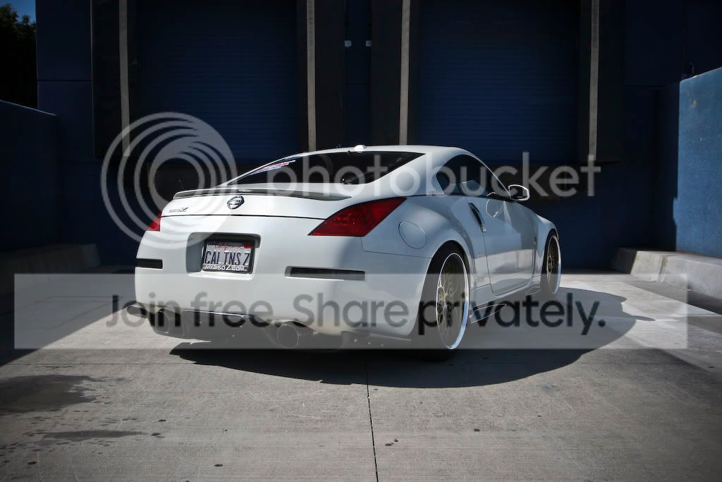

The rear is 19x11 +13 with a 275/35 tire

The tires will be Hankook Ventus V12 evo K110 and the BBK that i'm leaning towards is either AP racing or the Alliance BBK 14" 6p front and 13" 4p rear combo for either BBK.\
Calin, nice setup, I assume your fenders are rolled?
