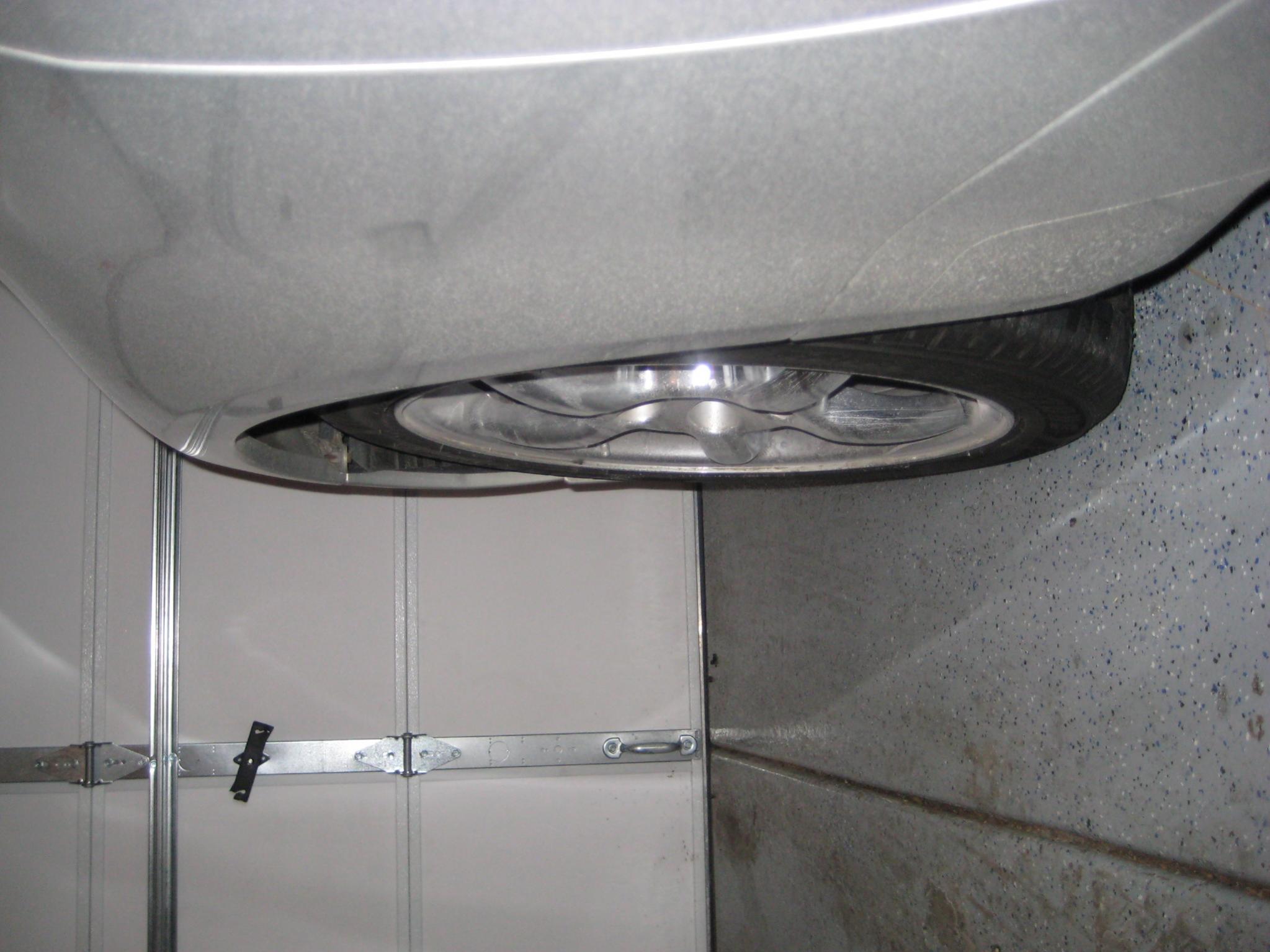

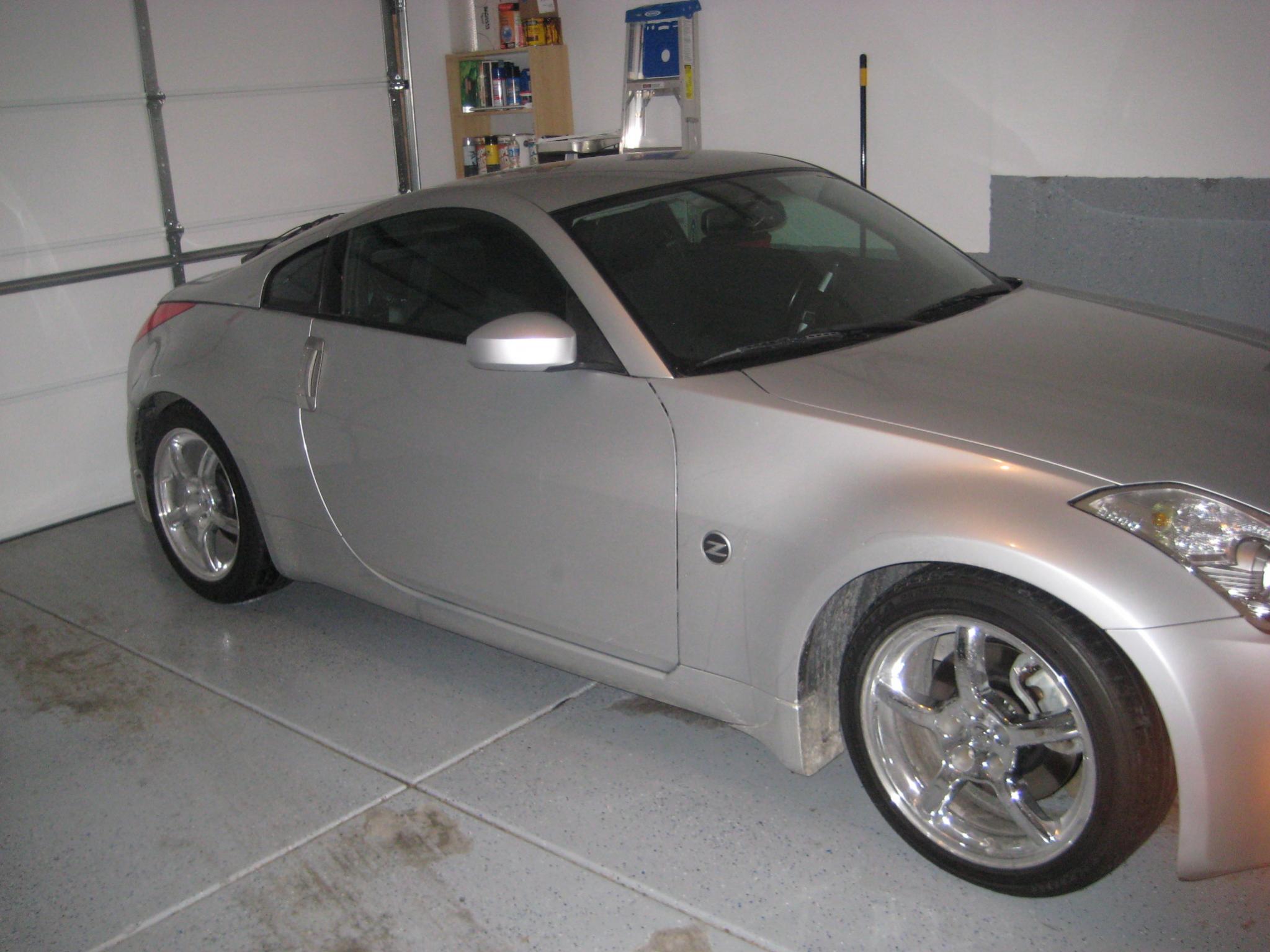

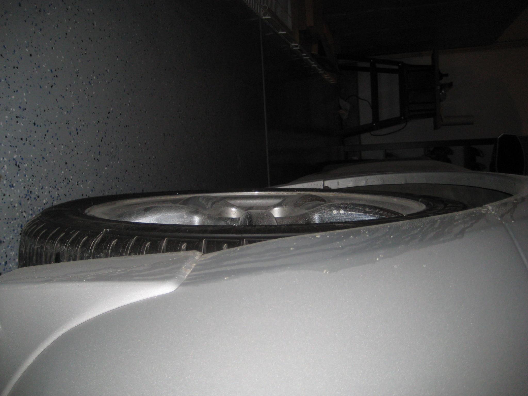

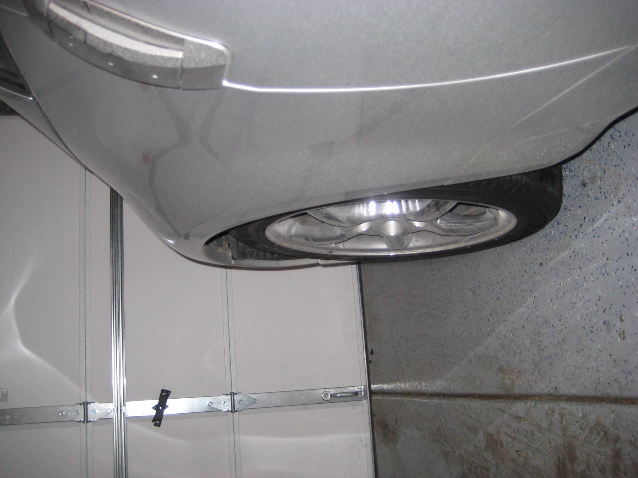

could someone please help me out...my wheels look like they are hellflush (at least I think thats what its called)...they look angled...the top of the wheel (towards the sky) is more inward to the car and the bottom of the wheel (towards the ground) is more outwards to the car...
is this normal for a 2007 stock 350z...

they are hellanotflush.
top of wheel inward to the car is called negative camber.
normal camber for the rear is -1.2ish.. you actually might have more than that.. there is an illusion of alot of negative camber when you put a high offset wheel in the rear, since our fenders come out..
you would probably need to add a 25mm spacer if you want to be 'hella flush'

far from hellaflush, more like hellasunk

lol, those are the nissan aftermarket wheels correct? those look pretty sunken in there. find the offset on the back of the rim, and post up. well find you a spacer to bring it out some. should you go with a spacer, go with a pre pressed hubcentric like the ichiba v2.

lol...sorry about the comparison to hellaflush...searched around and its obviously not...
but is this normal for a stock Z...to be sunken in that much...thanks...

ahhh...i see clearly now...thanks chebosto...i just wanted to know if it is normal for a stock z and it seems it is...hellaflush would be more if the top of the wheel was in line with the fenders...is this correct...

Hellaflush is looked down upon by many people and others love it, so tread carefully. It is when people buy 12" wide rims and 245 tires and lower their car without camber correction until it almost sits on the sidewall of the tires.
And yes, that look is normal for a stock Z.

add 25mm spacers all around and that shud help bring out the wheels more...it also depends on how low your car is now too...g/l man...

Very unusual. Maybe something is bent.
