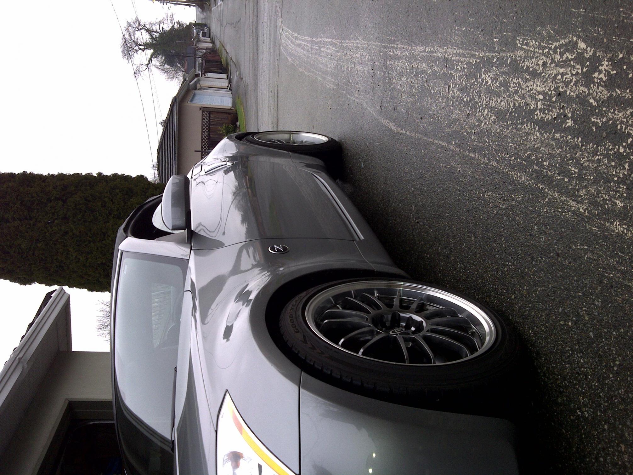

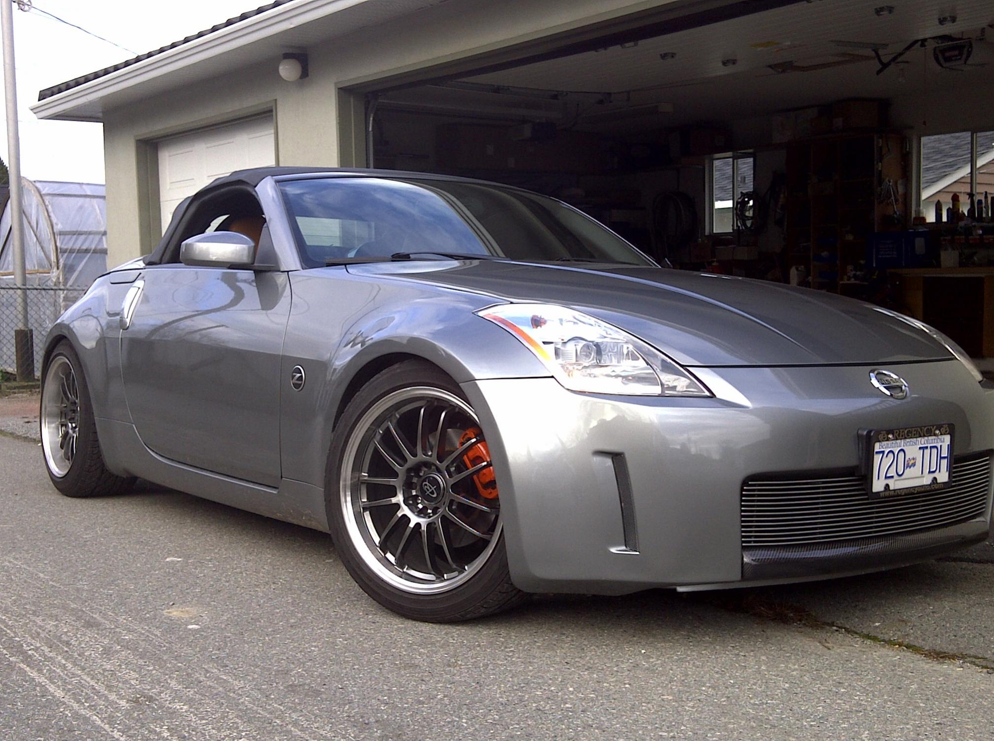

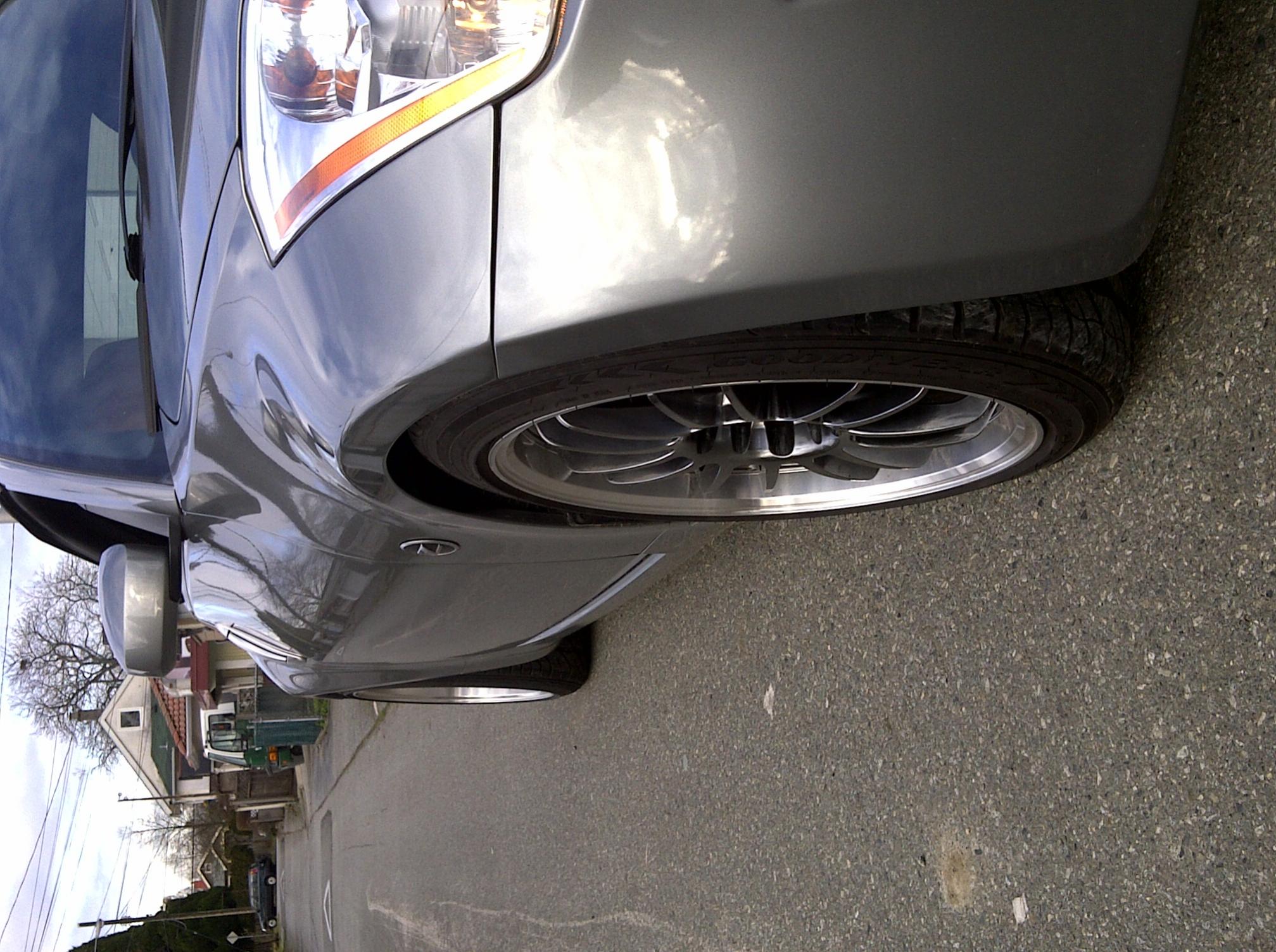

I'm running 18x 9/10 with +22 offset. I'm almost flush. Ill post pics when I get home.

Okay, so im at work and dont have time to take pictures of the wheels properly, so ill just post up the best ones that show the wheels that i have available on my phone. (cars parked in garage at home all winter). So sorry for the crappy pics.
These are 18x 9/10 + 22 offset

I think you could go a little further than 22 offset. I'm at work, so I'm using my mobile, so I can't link it for you, but google.. Offset calculator, or wheel size calculator, and if you punch in the info you have it'll tell you how much your wheels will come out. I'm not 100% sure on this, but I think if you go 18x10.5 +15mm offset your wheels may come out past the fender. I think you should search the forum, or google and see what that kind of set up looks like on our cars. It may be perfectly flush, you never know, but you should double check before you buy the wheels.
