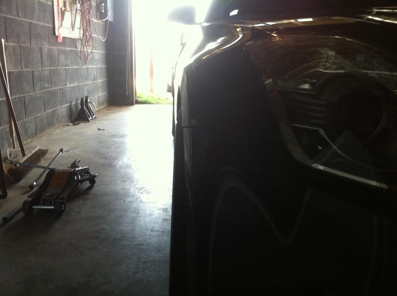

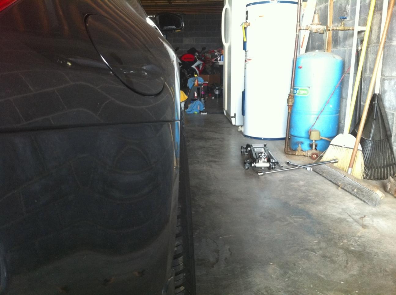

Not sure on what exactly I should do, but i would like for my wheel/tire setup to be a little more aggresive looking without getting new wheels. I have 19x10 rears +18 and 19x9.5 fronts +22 with 275/30-19 rear tires and 245/35-19 front tires. Should I get wider tires or spacers or what? I am going to be concentrating on handling for the most part with my Z if that makes a difference in what I should do. Thanks
here are a few pictures for reference....

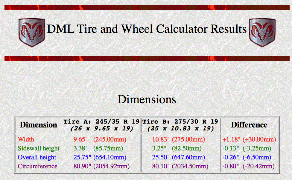

275 is the right width for a 10" wheel, although you should be running a 275/35-19 tire not a 275/30. No idea why your rears are 275/30. Those are shorter than your fronts while they should actually be taller than your fronts which can mess with your VDC/TCS.
As for more aggressive looking, well offsets are the primary factor in that respect. Bigger tires will just bulge after you go too wide and compromise lateral handling. You can try spacers to push out your wheels further if that's the look you want.

YOu want handling? Remove the 275/30's and install them up front and buy 275/35 rears install them ont he back . Your now good to go.

As mentioned front tire is taller than rear.
