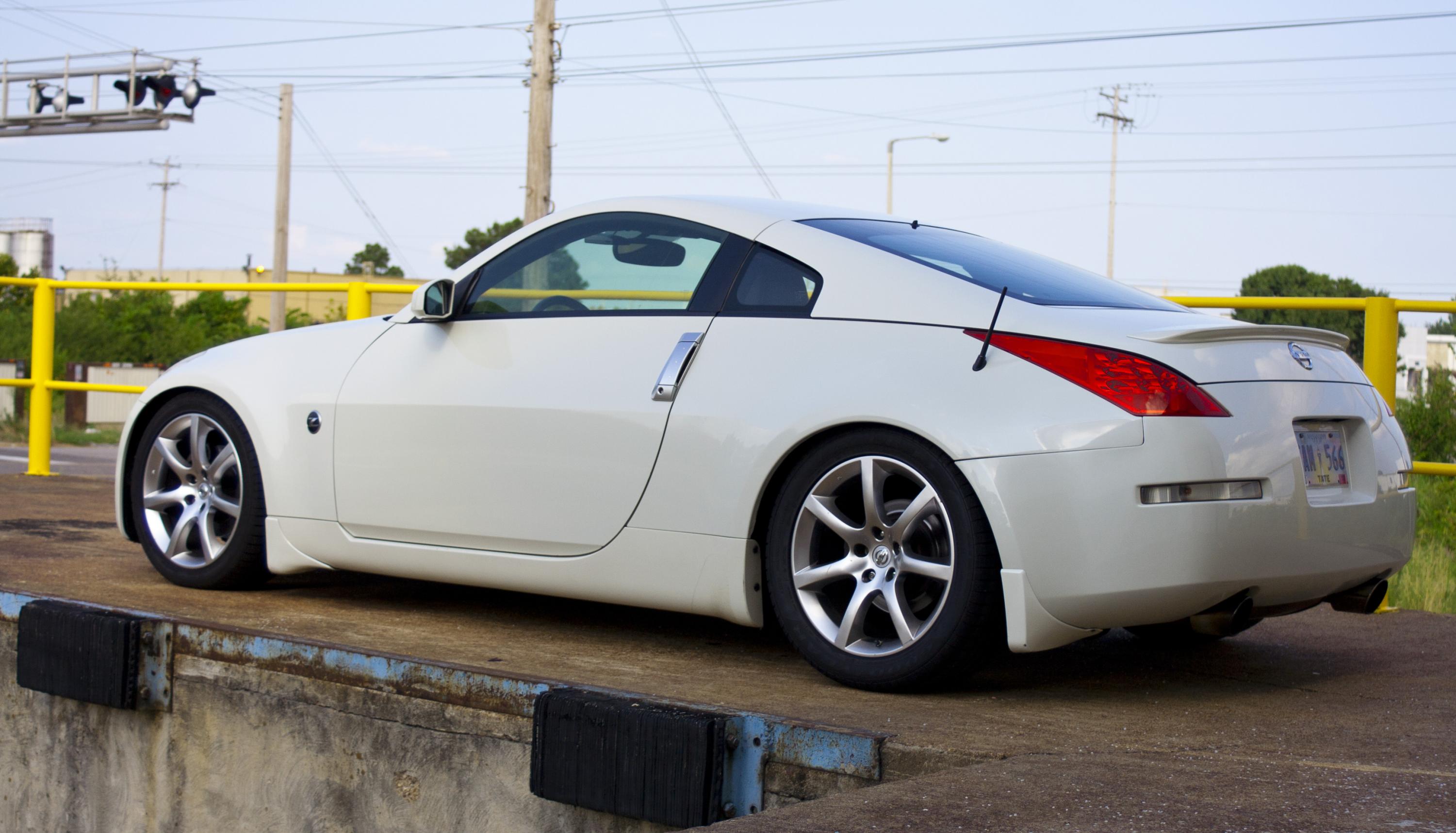

i am lowered with an eibach pro-kit but he isnt lowered at all. my rear wheel tucks in my fender as it sits now, so will the wider wheel/tires affect me at all?

edit: i attached a pic of my ride height

thank you. so im guessing i should be fine in the rear? i have 255's and PLENTY of room. im just not sure down to the mm how much room i would need with that setup.
19x10 +22 rear is ok with a 295, but look at my other post as well, as I don't think the 19" wheel is ideal though that price is great. If it's just for fun, it's fine. 255 rear? That's cute.

295 on a +22 & lowered car, i would suggest you roll your rear fenders..
what camber are you running now, or just whatever it is after the springs?

the camber is at like -2.4 or -2.7 in the rear after the drop i *think* if i remember correctly after my recent alignment.
and i get what your saying about the acceleration. who knows, if the wheels look good, after i wear out my tires i may just use my stock wheels with hoosiers. And just keep the nicer wheels with street tires since the autox will only be a few times a year. we have a 6 week old and my wife would appreciate the cheaper tires. hah
