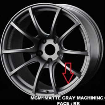

Well, we can easily find out if they will fit the 18x10s if I either send Cheston the template or if he just makes one himself with cardboard :
http://www.conceptzperformance.com/i...akeoutline.pdf
I don't know why I didn't get Brembos, I saw the Akebono kit and got an Akeboner. Thought it was a great price too.
I doubt there's a problem with spoke clearance, I am 99% sure the calipers will clear the spokes on the Weds.
It's the little lip around the barrel that might not clear. (attached) That is the problem I had on my 19x9.5 +28 SF Challenge in the front, I needed to get 5mm spacer for them to clear that little lip.
I hate the spacers, I want a wheel that fits properly by itself. If I can't get it with the Weds I might as well go for the CE28N's or TE37SL's since those fit for sure. (attached)
Attached Thumbnails Weds SA55M 18x9.0 +20 Akebono Clearance-weds-sa55m-mgm.jpg   Weds SA55M 18x9.0 +20 Akebono Clearance-rays-ce28n.jpg   Weds SA55M 18x9.0 +20 Akebono Clearance-rays-te37sl.jpg
