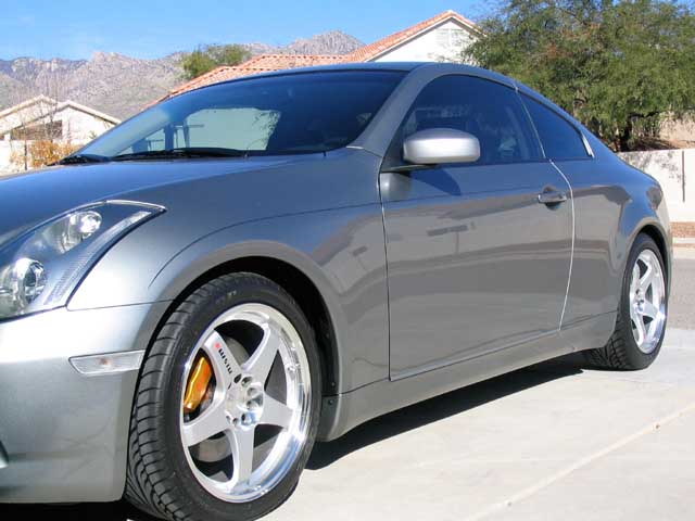

With the right tires, it's a great mod. I put on Dunlop SP9000s (245/40 and 275/40). The off sets are +25mm front and +30mm rear, which in my mind is perfect.
Lou
