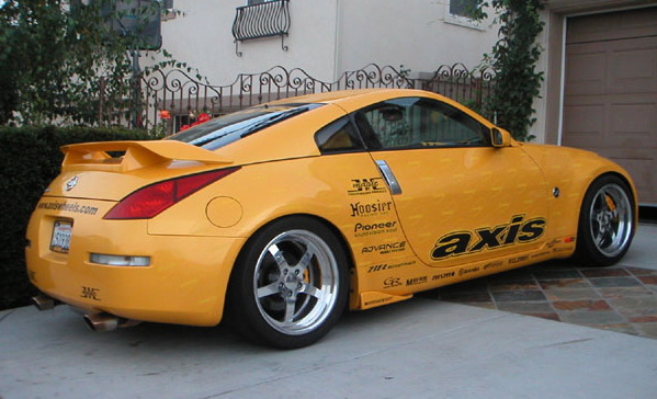

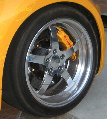

Tom,
Do I Have a Deal For You...
4- 18X10 Forged Aluminum Axis foot work Wheels.
3- 275/30r18 Hoosiers 1-still Brand New The Other two Have 30 Miles. on them.
2-305/30r18 also with 30 Miles On them.
I Will Let them go for $2,000. All Five Pcs.
I Would Like to keep them For My Racing Debut in '04 ...but I was Locked Out By My Employer.(Albertsons) so I Could use The Funds. I Bought Them from James
Over at axis wheels He Used them for The Ultimate Street car Challenge sponsored by Sport Compact Magazine.check them out heres a picture...

Originally posted by imelda
Tom,

Originally posted by 350ed
You need to roll your fenders for those tires right?
Didn't know NE1 was running 305's.
JAMES @ AXIS SPORT TUNING ,
CONFIRMED THAT THE REAR FENDERS ON THE AXIS 350Z
FEATURED IN (FEB. '2004) SPORT COMPACT CAR MAGAZINE.
HAVE BEEN ROLLED.
