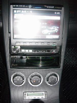

i just wanted to thank nwind21 for the tech support for my tein type flex w/ edfc.... sorry for waking you up several time man.. and thanks for the cd rom also....and mike wazowski for doing smooth business through the internet, i appreciate the fast shipping and all... about what i think on the set up (tein flex w/ edfc) i love it though i think i need to still upgrade my sway bars... plus i'm getting some noise coming from the back, still yet to find out what the hell it is... anyways, thanks fellas....

is it a squishie noise?, describe the noise.

yeah that and some type of rattle when i hit a bump or some'n... watcha think it is? havent done research on it yet...

does it occur at every setting or only on the soft setting?

havent fully looked into it yet... why is it supposed to happen at certain settings? let me know thanks....

you'll get some slight wooshing at the softest settings. that's normal. as you go stiffer it should go away.
you said it sounded like sand getting tossed up your fender well. that's something I've never heard. if it's that loud, then something isn't normal.

I get rattles on the rear passenger side. 8 months and I still haven't been able to completely fix it. I've noticed if you drop the strut and clean the pillow ball it tends to help for about 2 months- but always comes back. It's not anything extremely loud but noticeable. A few other guys running Teins here in the bay area all get the same noise as do some JIC owners.

I had that rattle on the rear passenger side before... till I found out that I had mis-set my stiffness (the ride side was stiff, the left side was soft).
Once I popped in the EDFC and got everything set properly, no more rattle.
