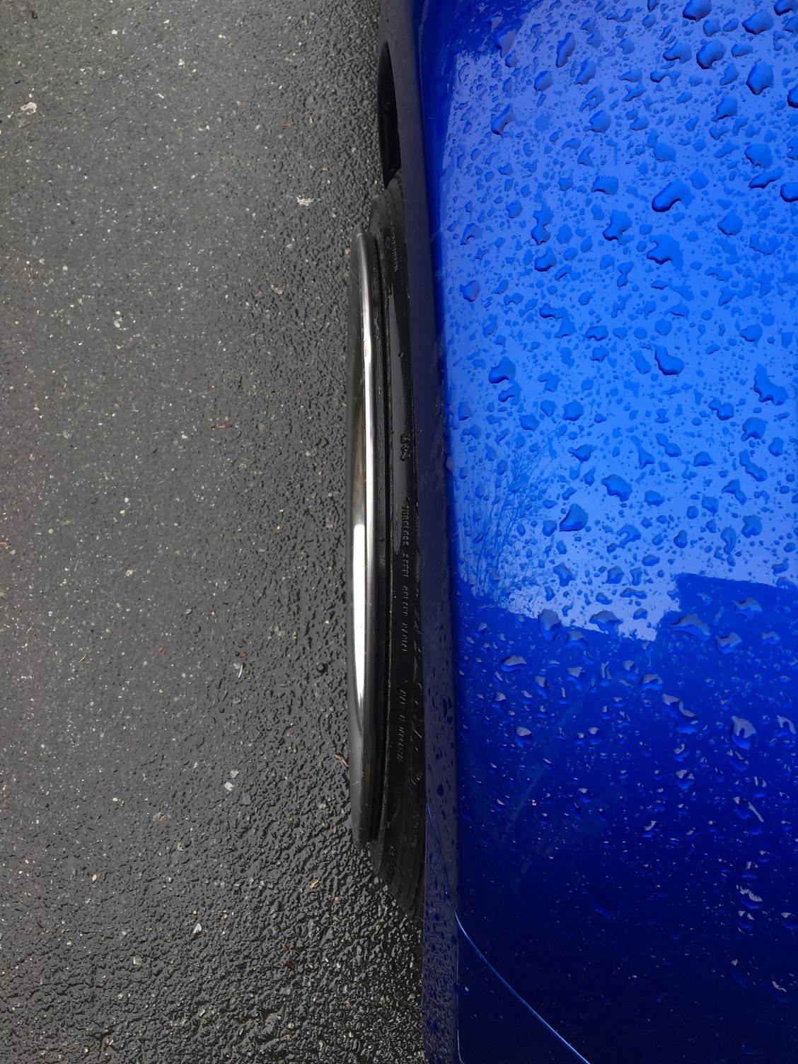

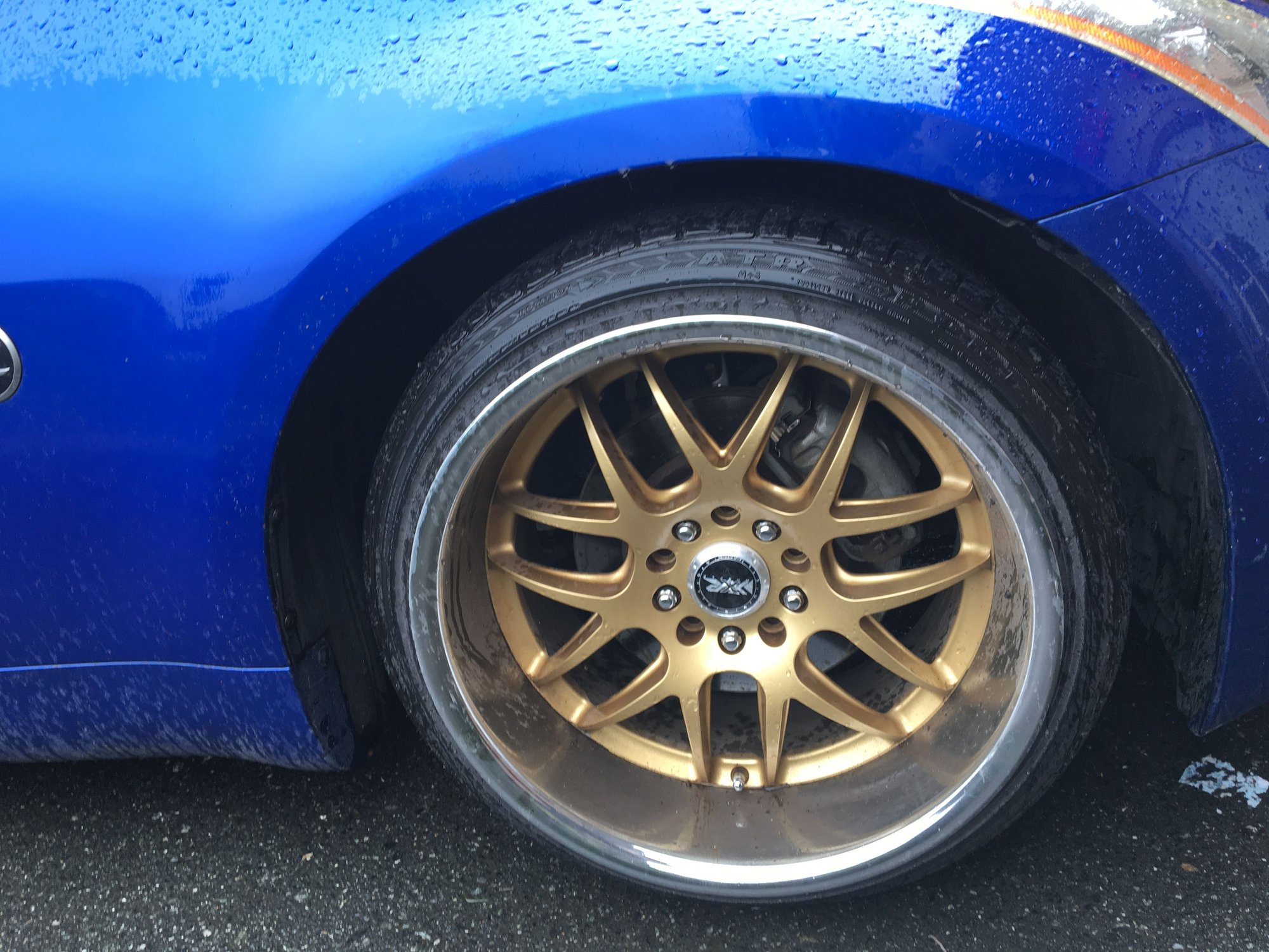

Noob here looking for some advice on what I can/should run
Bought the car and hate how it looks as is, currently has a 18x10 (offset was unknown by previous owner) all round set up with 225/40/18 & 245/40/18
Was at a few tire shops and they recommend going with a 245/40/18+275/40/18.
I was hoping to fit a 265+295, do you think that would fit?
Dropped about an inch on Eibach pro series,
Was hoping to run a little wider to loose some or all of this stupid stance, don't mind fender rolling, any other suggestions appreciated. Sorry if I'm missing something or this is the wrong section to post this.
First two things, post a pic of the wheel, many of us may know what you have. Second, are there spacers installed ?
I'll get right on that, any preferable angles? And no, no spacers. Not sure how to make them smaller pics soz. And yes I know cheap rims/this brand are frownded upon here before any comments are made ;P they came with the car so I'm stuck with them for a bit.
I believe they are +20 , you will have no issues with a 295/35 rear and 265/35 or 275/35 front
