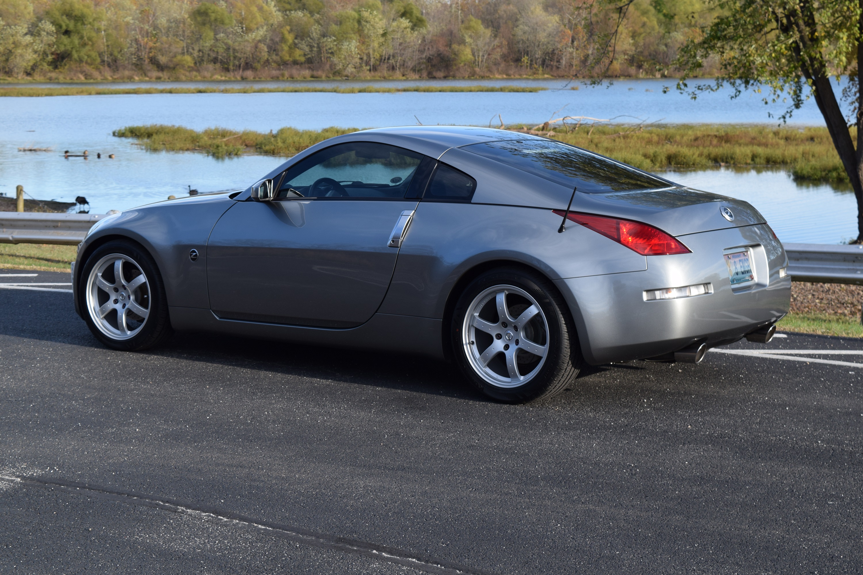

While I don't have either Brembo or Akebono brakes, I do have a set of 19" G35 wheels and a set of 18" Track wheels. Both fit the Z perfectly and I am certain that both would clear either of the brake calipers. Here are pictures of my Z with each set of wheels.
It looks good with the G35 wheels, are you running spacers?
