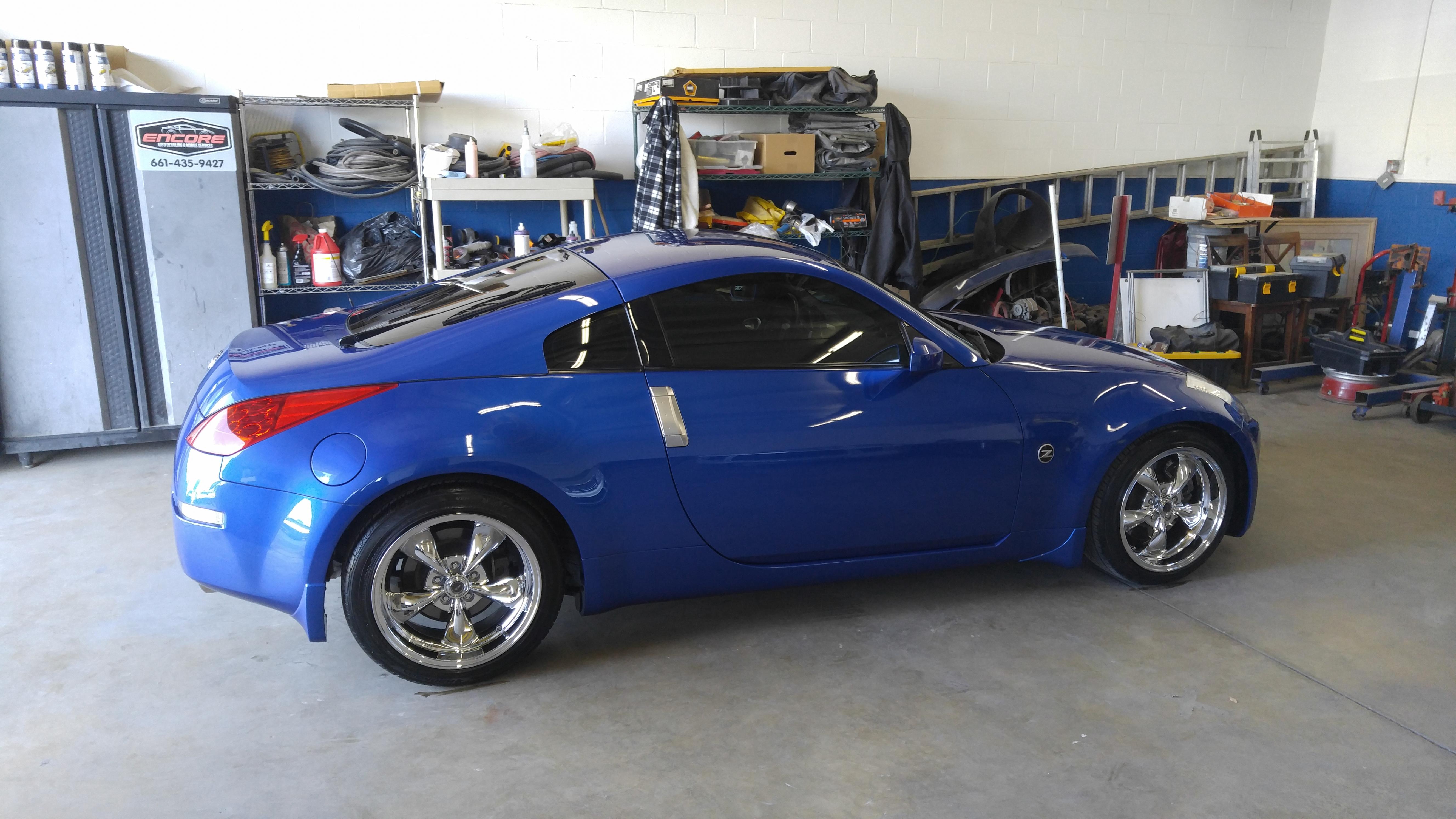

From what I can tell the American Racing wheels are 29-33 pounds per wheel. You are right, it may be a wash. I'll compile a list of tires, wheels and their weights to see if I am gaining anything.
Here is a pic of the car as it stands now....the wheels are growing on me, but I am not in love with them.
Attached Thumbnails Wheels, Tires the more I learn the more questions I have-20160510_174034.jpg
Was thinking that we're splitting hairs here but dayam.... 29-33lbs per wheel?!?!
I gots me a tuna boat in San Francisco bay that need those to keep it right in that one sweet spot for fishing.
Sheesh, was thinking Nismo V3 rears were heavy.....but these, dayam!

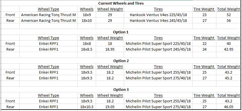

I was a little off on the weight of my wheels, but they are still too heavy. It also appears that the wheels are 18x9F and 18x10R. Weights tend to differ, depending on the website, from 27-30 pounds. I decided to go with the number I saw most often, 29 pounds. I put together my current wheel and tire weights and 3 options in the attached chart. Not matter what I decide to do I should see an improvement. I would love to get the Volk TE37s unless I can find a used set I do not think they will be an option. Thank you guys so much for helping me learn.
BWD
Attached Thumbnails Wheels, Tires the more I learn the more questions I have-wheel-options.jpg
