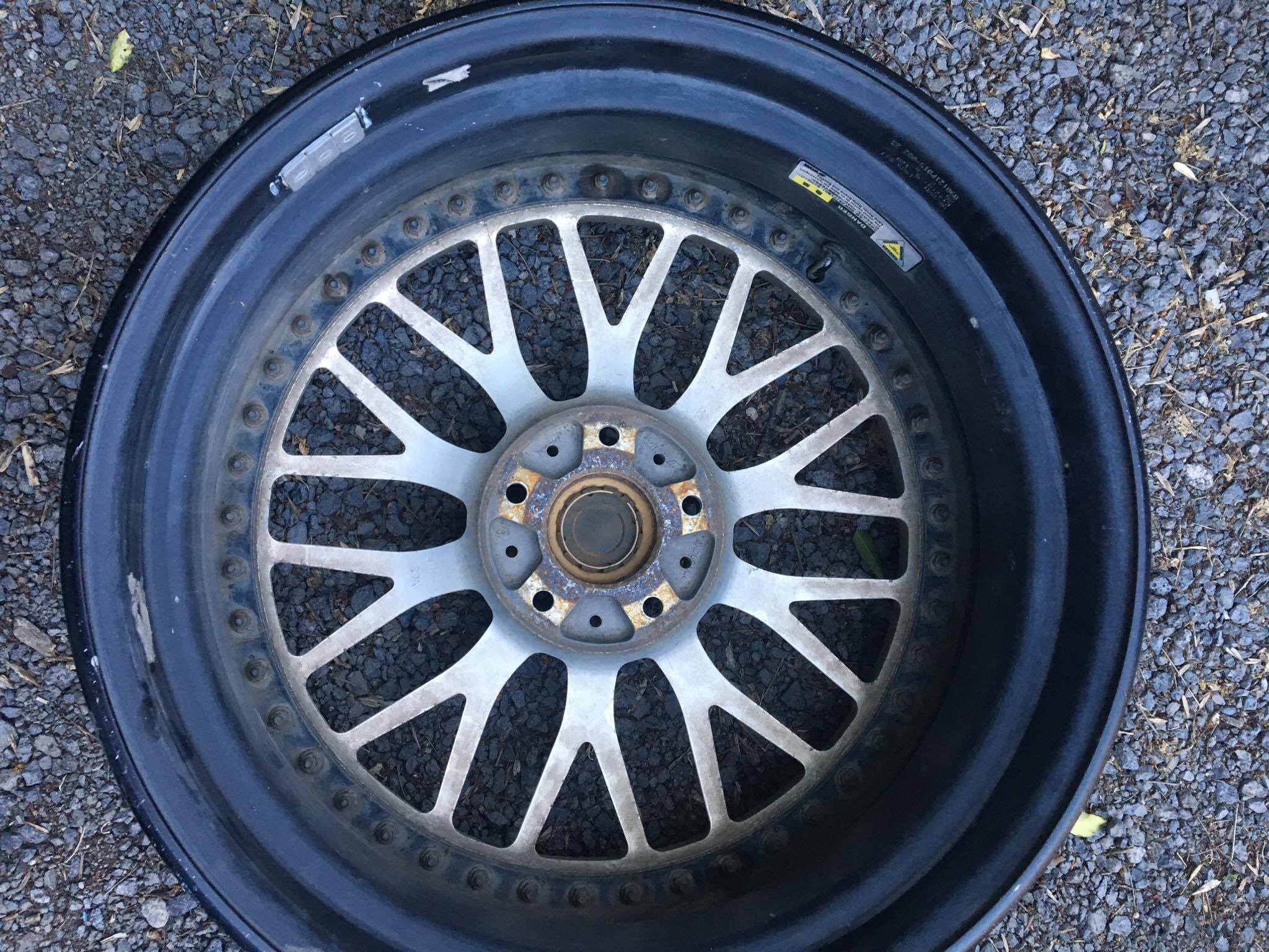

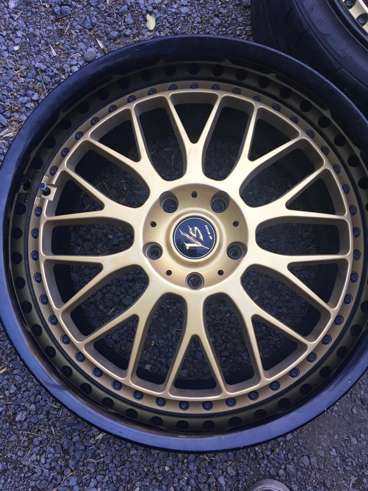

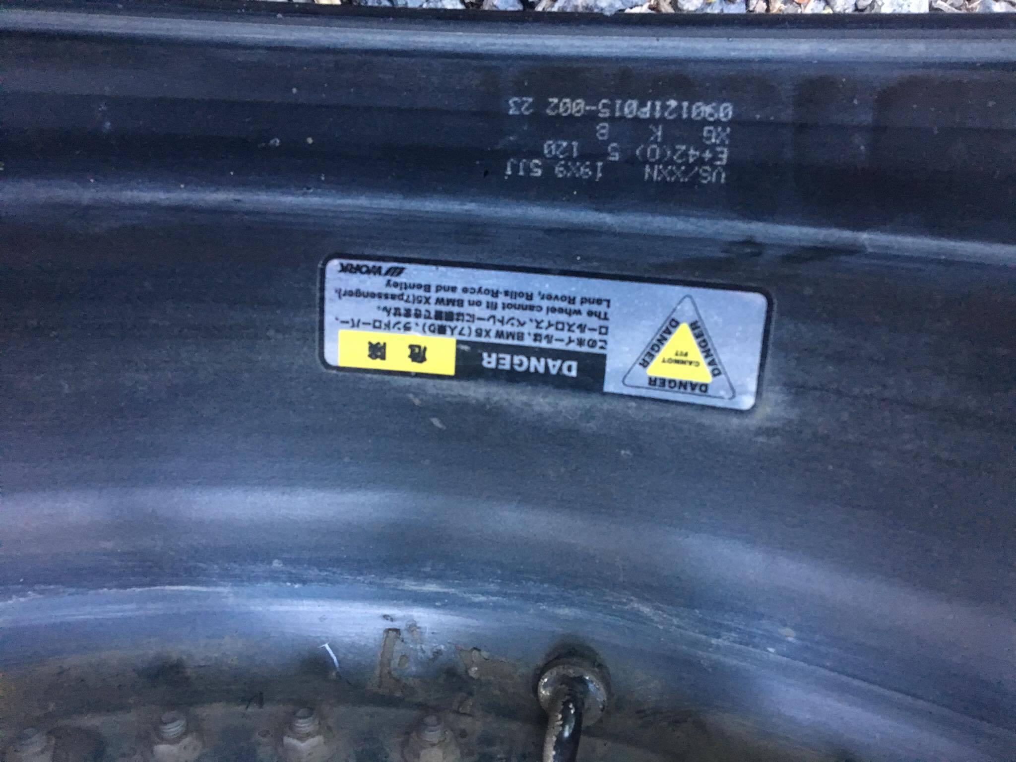

I just bought a set of used 19" work vs xx wheels for my 03 g35 coupe. The guy I bought them from had almost no information on the wheel specs as they were off a car he bought and he did not seem very knowledgeable. I've been doing a bunch of reading as I'm pretty much a newbie when it comes to all of this but I believe the specs are
Front: 19x8.5 E+40
Rear: 19x9 E+42
And I'm wondering what size tires would be good/ideal with cost in mind for the fitment as I'm a bit confused with what to go with. I have some pics I've attached if these are of any use. Forgot to mention the car is at stock height and the guy sold the wheels with four 114.3 5 bolt spacers

Tires.... 245/35-19 Front and 275/35-19 Rear
What size are the spacers (width)? Depending on how you like the wheels to fit, you will need to run AT LEAST 20mm spacers for them to look decent; but not much more otherwise you run the risk of taking out steering feel due to scrub radius issues.
But never mind the techno jargon, suffice that those Honda-size wheels should not be run without spacers on a Z, offset is way too high and the wheels/tires will look like an infant in a full size tub....sunken in and "small".

G35 coupe can take more aggressive fitment than 350Z AFAIK
I like offsets of +12 F & +10 R on 350Z
that said at least single digit on G35 coupe so i would want + 0 F & R and those offset you have are too high and 5 x 120 not 5 x 114.3
anyways even with 25 mm spacers your looking like sucked in

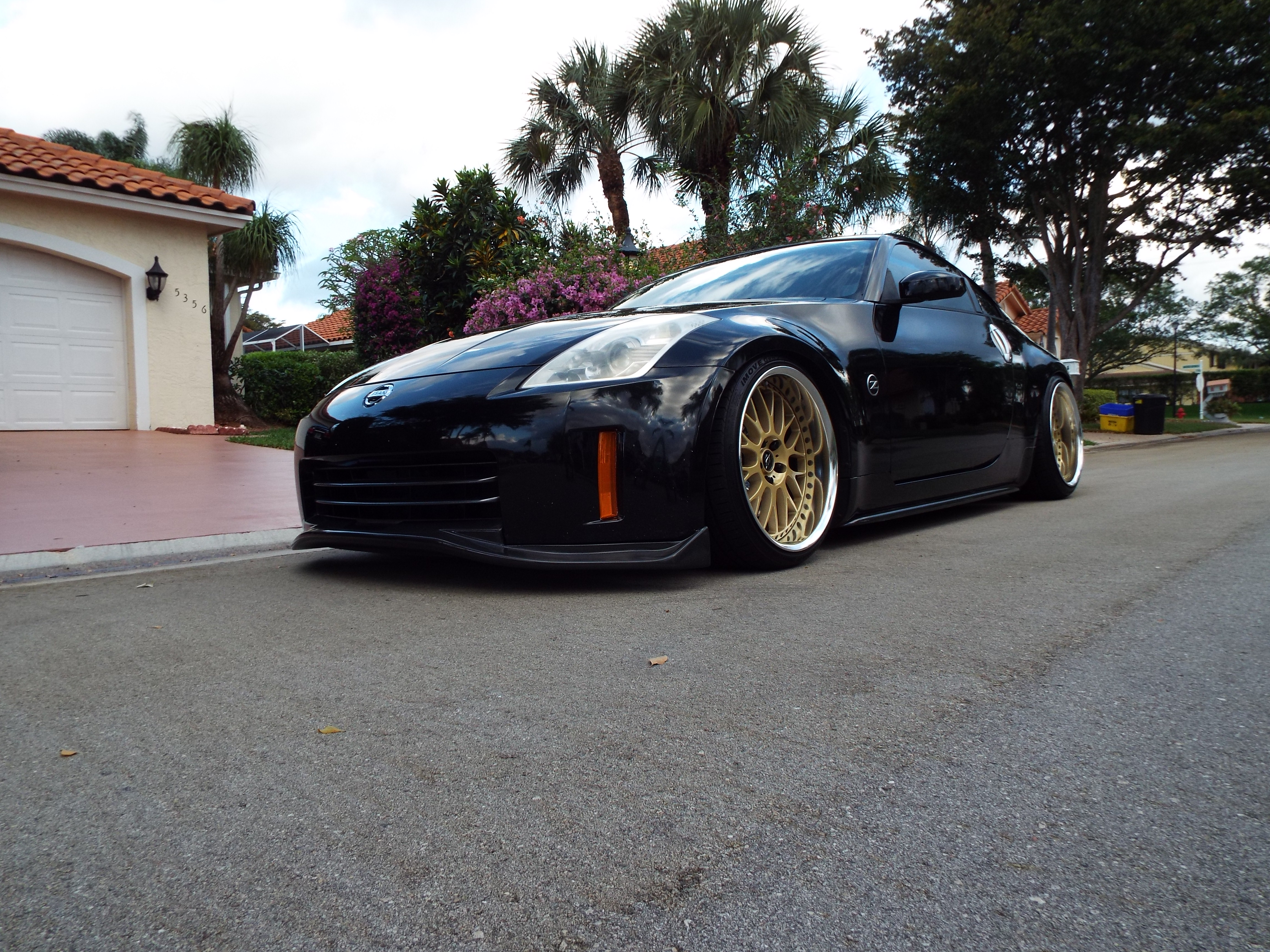

19" VSXX + 12 & + 10

... and those offset you have are too high and 5 x 120 not 5 x 114.3
Uhhhh, did I take a wrong turn and end up in the BMW forum somehow?
EDIT: Ooooops, just saw why you said that... ooops. Maybe those "spacers" are 5x120 == > 5x114.3 *adapters*....one hopes.

Sell those wheels and get wheels that are correct offset(+12-22, stock is +30f +33r) and 5x114.3. If you have to use adapters then you don't want spacers with the adapters. That sounds like a recipe for disaster. Next time, if you're not sure, come here and ask before you buy wheels you know nothing about.

Wellllllll, those 40+ offsets need a big spacer, right? Bolt pattern adapters are usually 25mm thick so if they ARE *adapters*, it could still work.
Why, no, I wouldn't do it; but the way I look at it, if one has to use them to fit those wheels, the 25mm taken off the offset of those wheels make them +15 and +17, so what the hey.
