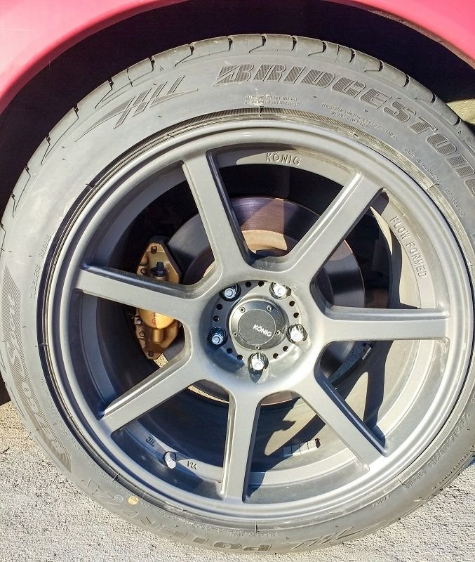

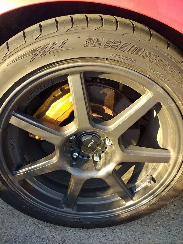

By the way, thanks for the help, and they clear just fine.
front
lots of room
rear
even more room
