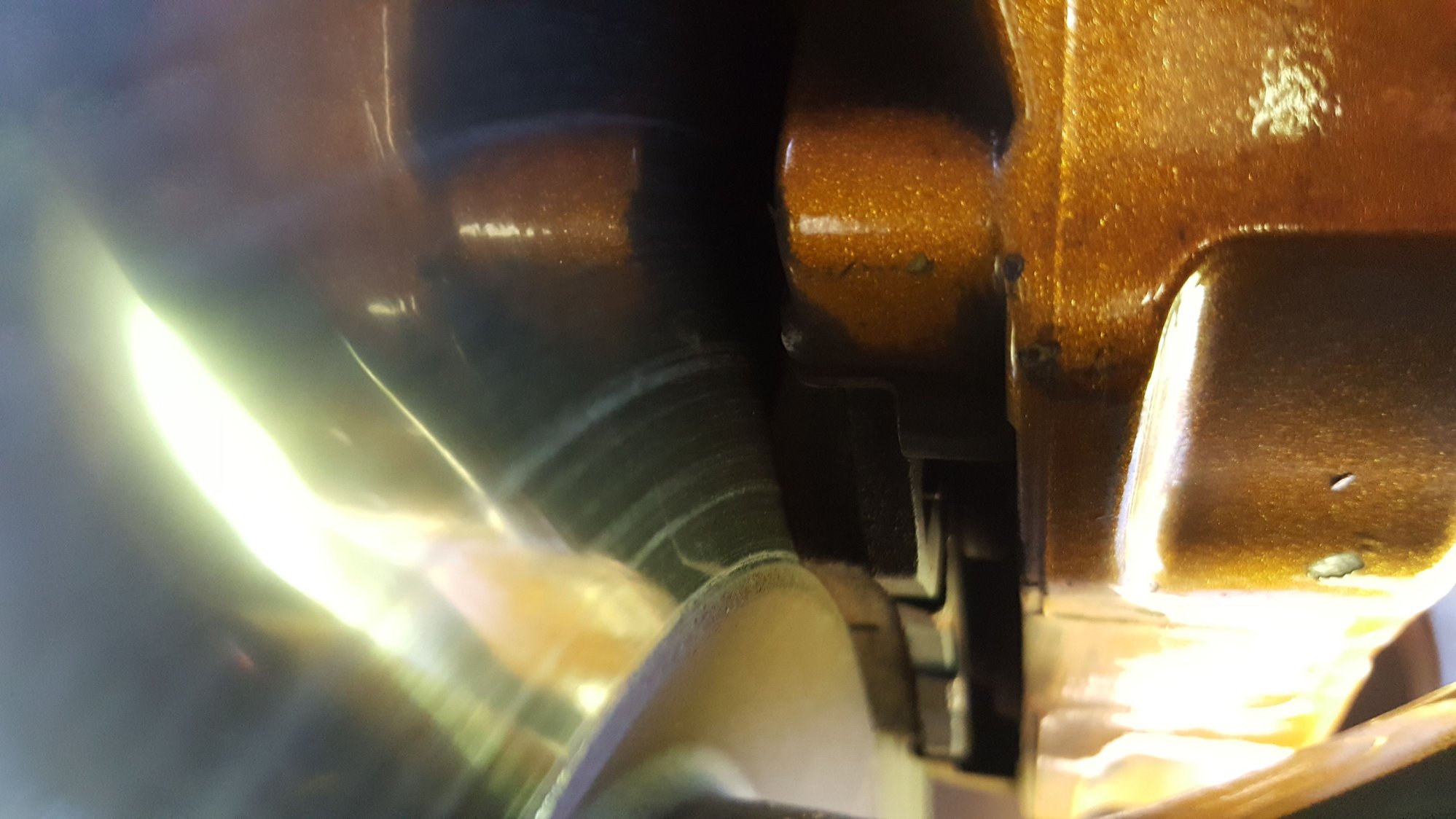

noticed this. Should the brake pads be that close to the rotor when parked?
