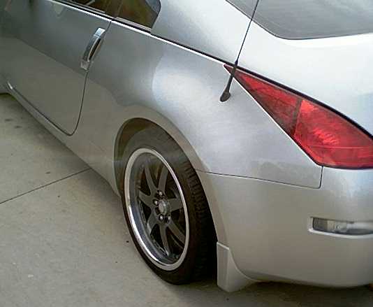

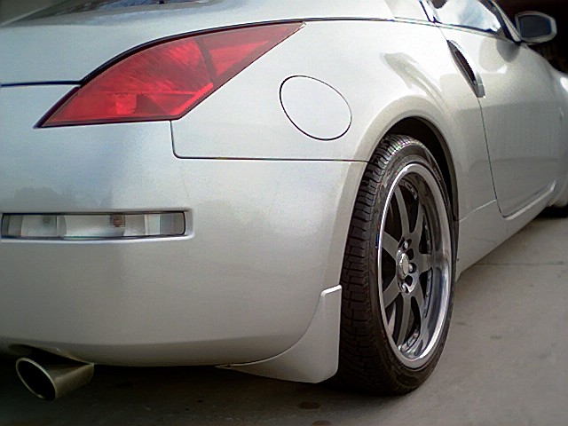

yea , i got hig quility adapters from a person that does them for porche's wheel , mine were off and eclipse , here are some pics

1 more

and my car handles better then stock rims thats for sure and i have 235s in the back.... i'm going to get 255s but for now its perfect , no shaking , i dont have a clue where u got the bs about handling like sht but i guess unless u know what ur talking about ...shhhhhhhhhh ,
