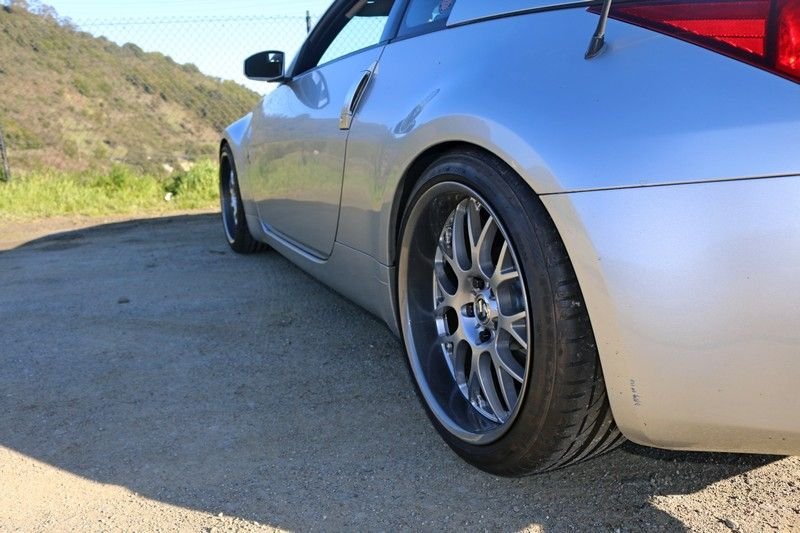

"9.5 front, 10.5 rear, 255/40 front, 275/40 rear"
+1 w/ front offset +15 to +22, rear offset +15 to +20.
Obligatory pic:
255/40 18 x 9.5 +22
275/40 18 x 10.5 +18
