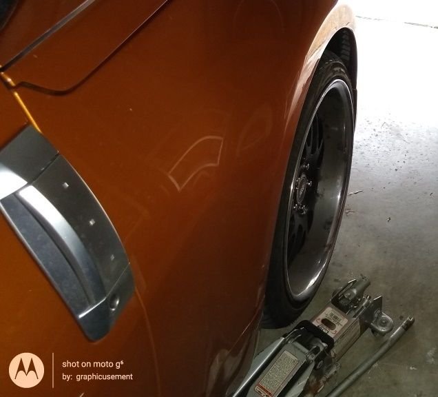

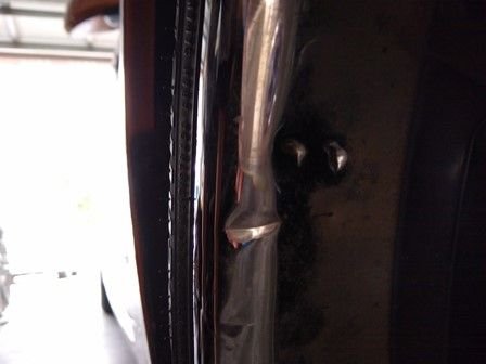

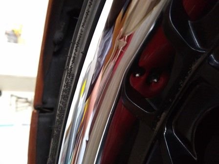

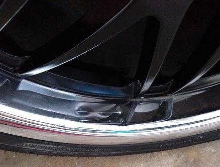

Tire Kingdom ruined my front rims during new tires install.
My rims are no longer available and i need a whole new set now.
TK is only offering me 500 for the 2 front rims even though I need to
get the whole new set. So now I am looking for cheap rims under 1000.00 bucks
My Concept One RS8's are 20's 8.5 front and 10 rear
The front has an offset of 30 and rear I can't read here are some pics.
The rubber is 245/35/20 and 275/30/20
Either way what I'm concerned about is what range of offset can I use for front
and rear and be close to flush for 20" rims 8.5 front and 10.
front offset is on spoke 30mm 10++++is on both rims not sure what that means
rear offset not visible on spoke will remove other side to see if visible on other rear wheel
You might have to zoom on pic to see it but front says 20x8.5 ET 10++++ then 30 on spoke
same for rear 20x10 ET10++++ but spoke # is not visible.
So basically safe range offset for 20x8.5 on the front and safe range for 20x10 on the rear.
Looking at rims with lip like the XXR 526.
Please help Im clueless at the offset numbers and to have it near flush to fender.
OH and suspension is stock and Im not planing on lowering it.

"Flush" fit for an 8.5" wheel can go down to as low as ~10mm offset
"Flush" fit for a 10" rear wheel down to ~15mm offset
Have no clue what 10++++ means. Can only presume it's some kind of mfgr code.
You have to stick with 20s based on your keeping the presumably new tires? Else, I'd suggest going down at least an inch to 19s.
In any case, would suggest going wider in front, say, to a 9" or 9.5" wheel in which case lowest offsets for "flush" fit is 15mm for a 9", 15-20mm for a 9.5
