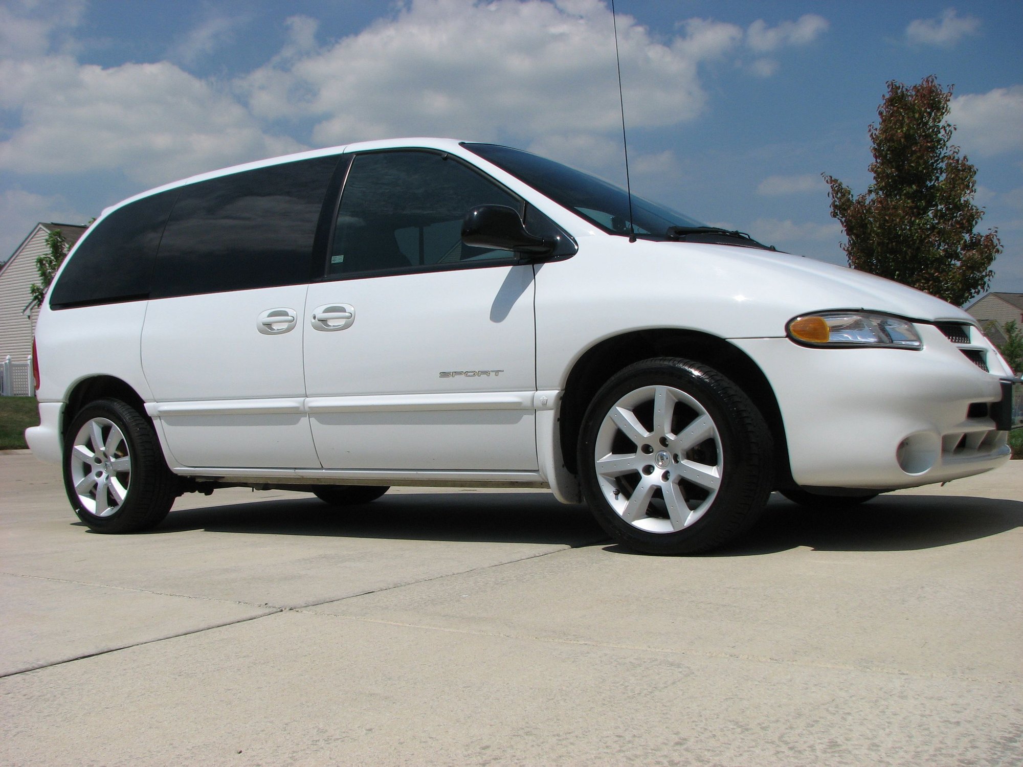

I ran my 17" 350Z wheels on a Dodge Caravan a few years ago.
