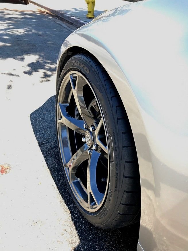

9.5 +22 with 255/35-19l (or 255/40-18 if you opt for 18s) will achieve that look but you'll need to drop the car a fair amount if you want it that low and you'll definitely need camber as shown. Adjustable front upper control arms (FUCA) are needed to give you that much camber and corrected toe/caster). You'll also need to cut the inner fender liner screw down.
Here's an example of 19x9.5+20 (Nismo V1 with 20mm spacer) with stock range camber (like -1.0°), set as such to avoid tire wear and retain steering response. Note that my car isn't dropped like the one in your picture (which actually look like 20s) but has razor sharp response.

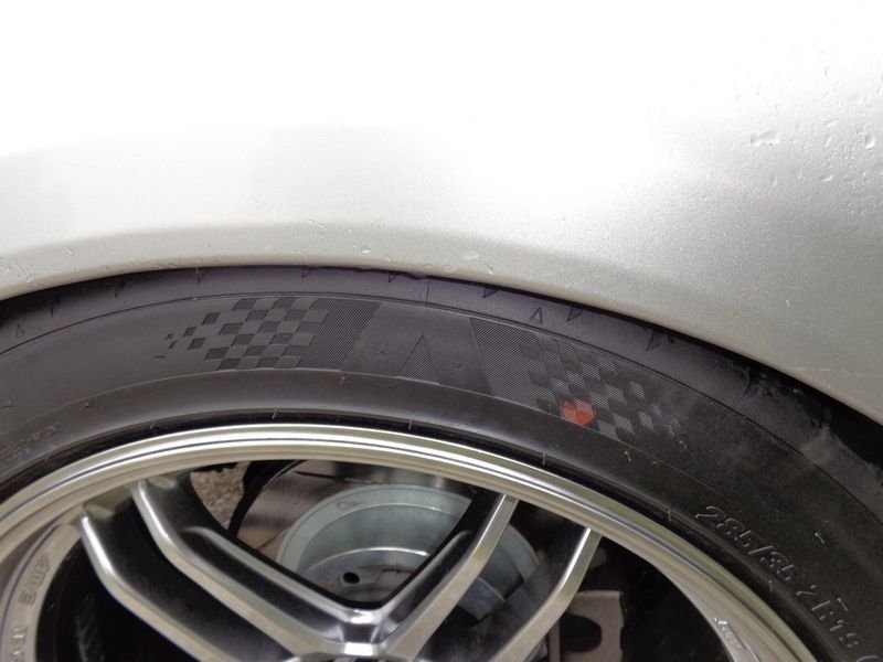

Here's a rear 19x10.5 +22 with 285/35-19 (or 285 /40-18), adjustable toe arms and offset bushing to retain stock rear alignment range (for same reason as front) at -2.1°. Fenders rolled and sealed. Fenders likely won't need rolling at +22 but I had +15s on it that necessitated roll and seal. But with them rolled I now run my Volks at +8 and had a set of 305/35s on the car for a bit. Which I could NEVER get hot enough to do any good.
