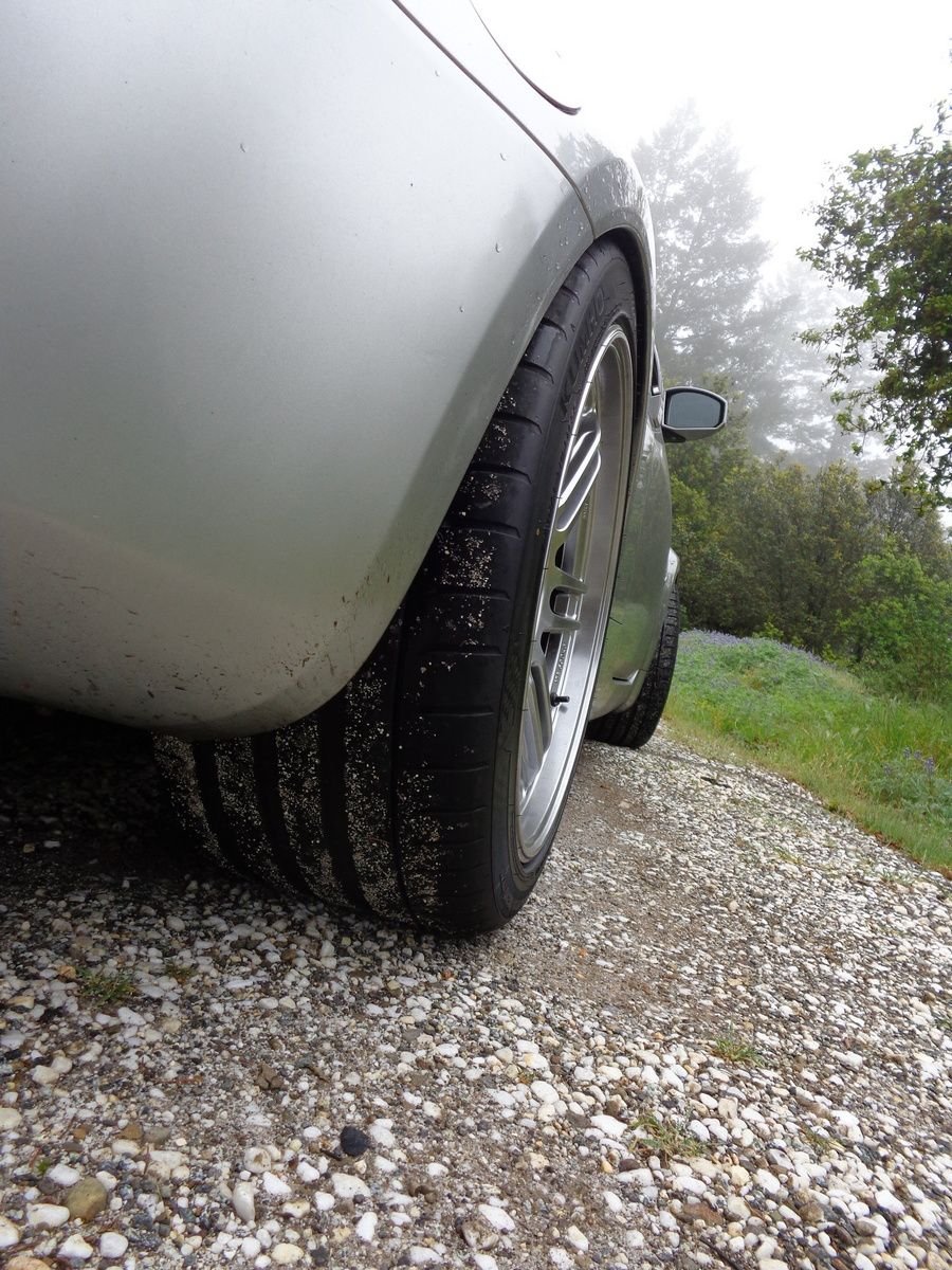

Just for reference, I've run over two dozen different sets of wheels/tires. Never had to roll until I ran an Enkei RPF1 *9.5* +15 on the rear. Yup, a narrower wheel than my usual 10s and 10.5s but that 7mm less offset caused rub over speed bumps and driveways..
After rolling, was able to run a lot of different lower offset wheels like this setup....
This is 10.5 wheel, 285/35-19 and that's about as wide as I'd ever need. Harder to get a big tire warmed up and sticky anyways. Oh, on Eibach springs and Koni shocks. No coilovers.
So, standard tire size recommendation on 9.5/10.5: 245/40-18 (or 255) Front, 275/40-18 Rear. (Or, if 19s, just drop the aspect ratio to 35% surprising how that works.)
