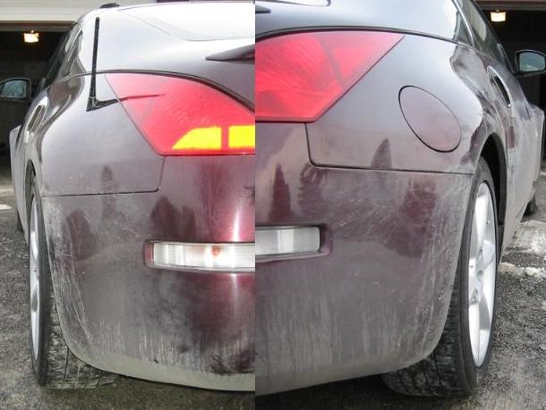

I've got H&R's 25mm bolt-on spacer which has offsetting bolts (saves getting new ones and having to get them installed into the hub). I took some new (clean) pics yesterday but here's an older one I took for comparison purposes. 25mm in the rear will certainly fill the wheel wells.
Left is spacer, right is w/o.

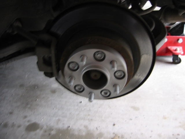

Here's the spacer with the extra offset bolts.
BTW, if you want to run the OEM bolts, 5mm rear spacer is considered the largest you can safely go.

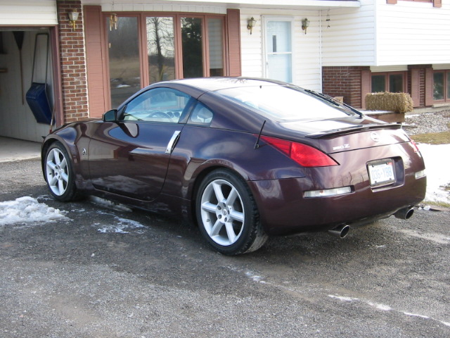

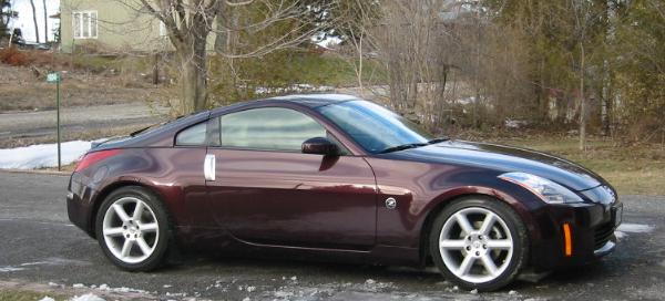

This clean enough? This is one of the pics, but I've better pics with rear shots etc... Gotta get the camera though. 25mm are on the back.
Yes, scrub radius is a factor which is why I'm carefully considering what to put up front. In the rear I believe it's not an issue.
thanks for the pics..
but cannot really tell from this angle...more closer pic from rear view 3/4
thank you

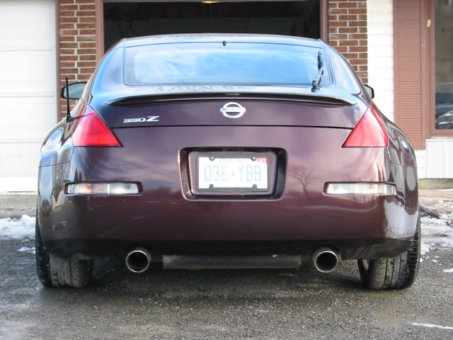

FInally got the pics to post.
thank you
Old Apr 10, 2004 | 09:35 AM
FritzMan's Avatar
FritzMan
Posts: 681
From: Ottawa, Canada
And another...
