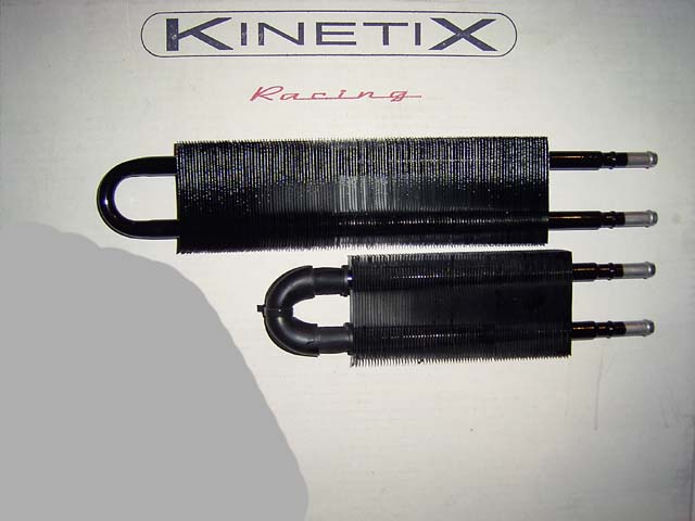

Do it your self. nothing hard about it at all. just be carefull when you drill the new hole, don't drill through the radiator. get a bottle of Nissan power steeering fluid. a little trick I used to help get the air out of the system B4 you reconnect every thing is to connect the TOP line to the new cooler and let the fluid circulate until it flows out the return end, them push on the hose.

The front bumper is so easy to remove & replace it shouldn't be an issue. You probably could install it without removal except for drilling the new mounting hole in the face of the radiator support.
