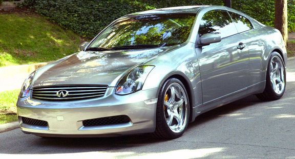

Not sure about the front, but I think you will have problems with 295's on the rear. I have 275's on the rear, and it is close (lowered with Eibachs). You probably will have to roll the fender.
