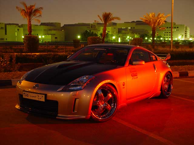

well i have 20" LD5's lowenhart's 9" front 11" rear ...well for sure i lose 0-60 time but the looks are great .....i use it every day
ok you lose some 0-60 but u gain stabilty on high speeds .
the ride is a bit stiffer but not much u would get use to it in no time ..but worth the looks u gain.
ok do it like this ...get the 20" for show and turning heads and keep the stocks rap them with Nitto's 555R and keep them for the drag and track days

well i have Ebach 1" drop springs for now pro kit .....smoth perfict and prevint the 4X4 look
but am going to get the tien flex soon
this is my set up

Originally posted by wa350z
Is it best to go with 20in with no drop or go with 20in with a drop
well i have Ebach 1" drop springs for now .....smoth perfict and prevint the 4X4 look
Attached Thumbnails How bad will I be hurting performance with 20" wheels?-dsc00686z.jpg
this is my car
