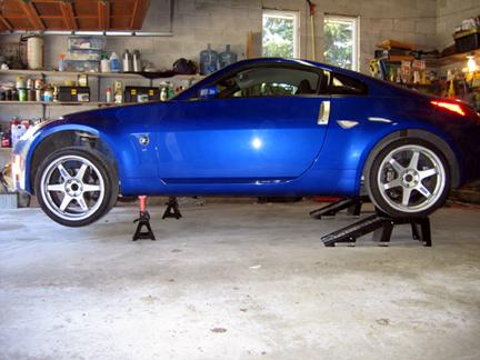

This is what I do when I have to do any work under the car.
Attached Thumbnails Anybody have any tricks to changing the oil?-img_0991small.jpg
