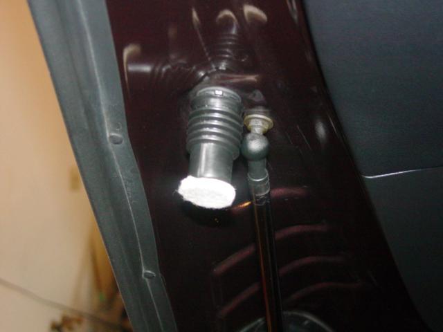

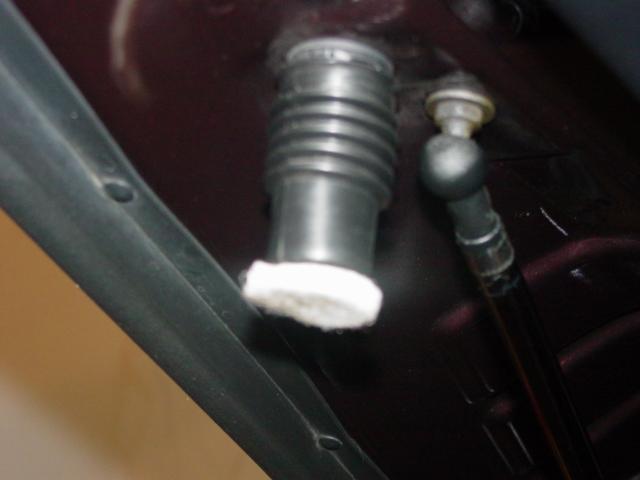

I haven't tried the penny trick but I hear it works perfectly. I myself used the ol' glue the felt furniture pad to the bumper trick and it has worked well. I have had to replace them a few times though since over time they get squashed down and don't work as well.

Pics:
Attached Thumbnails sticky rear hatch release-hatch-bumper-mod-1-small-.jpg   sticky rear hatch release-hatch-bumper-mod-4-small-.jpg

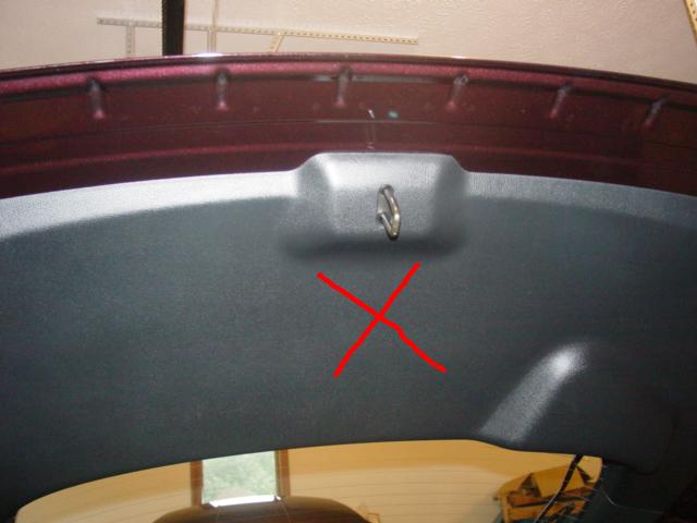

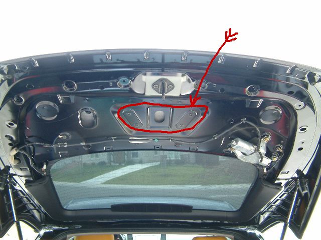

Also, taking out the weight from under the plastic cover will decrease the overall weight of the hatch and it'll spring up easier. This is especially true if you have a wing spoiler that adds to the overall hatch weight.
The first pic is with the weight removed.
Attached Thumbnails sticky rear hatch release-remove-weight-here.jpg   sticky rear hatch release-where-s-the-weight.jpg

You just have to take off the plastic cover and there are screws to unloosen and it comes right off.

that's really odd that you have a weight there. i have an 05 with no spoiler. when i took off my rear wiper, there was no weight. it was the first time that that part of the car had been touched.
