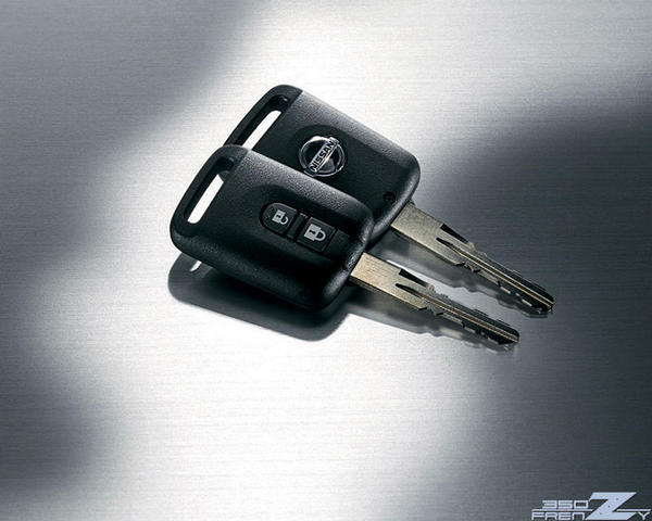

someone find a way to get the jdm key to work
Man that is sweet. Maybe the chip is different?

I dont understand why not....its made for the fairladyZ. why would there be a differnt frequency for an export model?
All I can say is "part number". Who can get a friggin' part number for this?
BTW, you guys might wanna suscribe to this thread which is following Jason@Performance who is going to test one of these JDM keys.
https://my350z.com/forum/2003-2009-nissan-350z/167608-why-couldn-t-the-z-get-get-this.html
