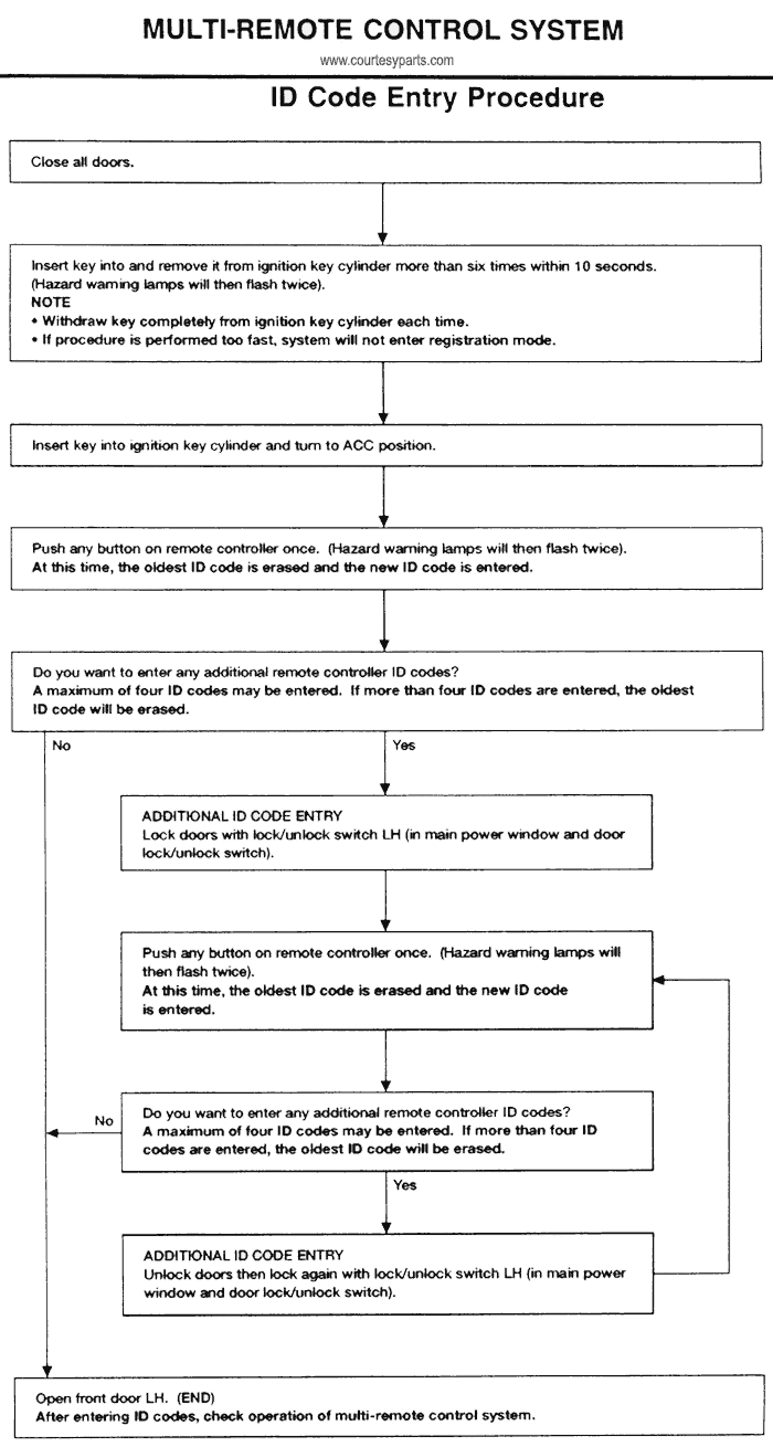

Old Jun 16, 2006 | 02:18 AM
yobri's Avatar
yobri
Joined: Jun 2001
Posts: 17,685
From: teh interwebnets
This will help.
Attached Thumbnails Lost Key and fob, how much to replace?-remoteentry_instr.gif

Old Jun 16, 2006 | 05:15 AM
MustGoFastR's Avatar
MustGoFastR
Posts: 4,797
From: San Diego
No Consult II needed to program fob; just follow the steps Yorbi posted above. Very easy, takes ~1 min.
For key, yes, Consult II is needed and I don't know if you can get a chipped key blank off Ebay or not. Performance Nissan can likely do you much better on the price for one, though.
