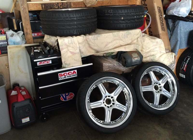

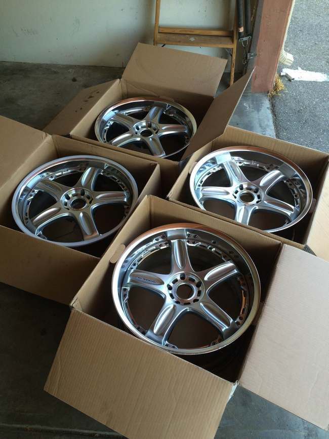

So I find this great deal on some wheels that will go on one of my cars or my son's car. Posted this a few posts back.
Wheel specs: Volk GT-C 19x8.5 +27 Front 19x9.5 +24 Rear, HUB CENTRIC (66.1) for Z! No hub ring adaptors according to previous owner! Haven't seen Z-specific wheels in a while.
Or so it was claimed. I asked beforehand what kind of car they came off of so I could get some hub ring adaptors. "350Z."
Excellent, methinks.
So far so good.
Got the wheels home and this morning, ended up buying a set of Bridgestone S04s, 245/35, 275/35-19 LOCALLY. First time I've bought good tires locally in a long time. Price - installed - was cheaper than TR, factoring in shipping and local installation on my existing (the Volks) wheels. Amazed me.

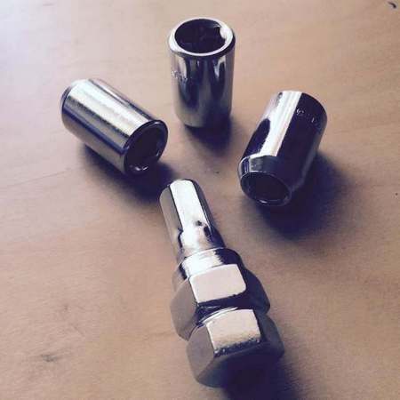

Before I go get the tires put on, I run off to Vex Motorsports, a local "tuner" place as they have huge selection of lug nuts.
Why new lug nuts you ask?
Well, usually, wheels requiring tuner lug nuts - like these Volks - are no-big-deal and the main concern is the size of the socket or tire wrench being too big (necessitating new lugs with thin wall socket). Well, not only are the lug holes on these wheels too small for the lug wrench and/or sockets, they're even too small for even the more popular tuner lug nuts themselves, e.g., McGard, Muteki, Varrstoens, etc!! WTF!! Dayam!
Ended up picking up a set of hex head lug nuts that were narrow enough for the lug holes and it came with a hex driver with a good old 19mm head protruding out past the face of the wheel so I can even use my impact driver on it without scratching the wheel. Cool. Oh, and in a way a minor theft deterrent.... I'm guessing miscreant wheel thieves are more likely to carry around lug wrenches than hex head drivers.... Har!
OK, note that I actually brought one of the FRONT wheels into Vex and we tried out the lugnuts to make sure they fit the lug holes. Perfect fit!

Finally get the wheels home. Set my butt on the garage floor and decide to throw on the rear wheels first.
Slip 'em over the lug bolts then go to start the thread of a lug nut. Won't thread. "WTF???" Keep trying. Nada. Take wheel off. Now remember what I said about taking the FRONT wheel into the store to get the lug nuts? Wellllll, turns out the rear wheels have the lug nut seat near the SURFACE of the wheel and the lug nut doesn't even go through the lug barrel.
Bottom line:. Studs too short. (Or I need specific Ray's/Volk narrow lugs that will insert into the wheel?? Or something.....??)

PS And no, don't really know what I'm going to do. I figure I have a few choices:
1. Install longer lug bolts and hope that works (which it will, I'm 98% sure). (Problem is I'll have to procure new lug nuts (open ended) for the Track V.1's if I go back to them which I probably will cuz these suckers are HEAVY!
2. Drill out the lug holes. Not a good option due to potential weakening. (Not likely but possible.)
3. See if there are "correct lug nuts" for this wheel.
4. Sell the wheels and take the loss - letting someone else deal with these issues. $500 anyone (wheels and lugs only)?? (I know this kind of posting is prohibited but it's contextually a minor detail.
EDIT: SOLUTION FOUND:
http://www.evasivemotorsports.com/mm...tegory_Code=L1
