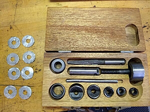

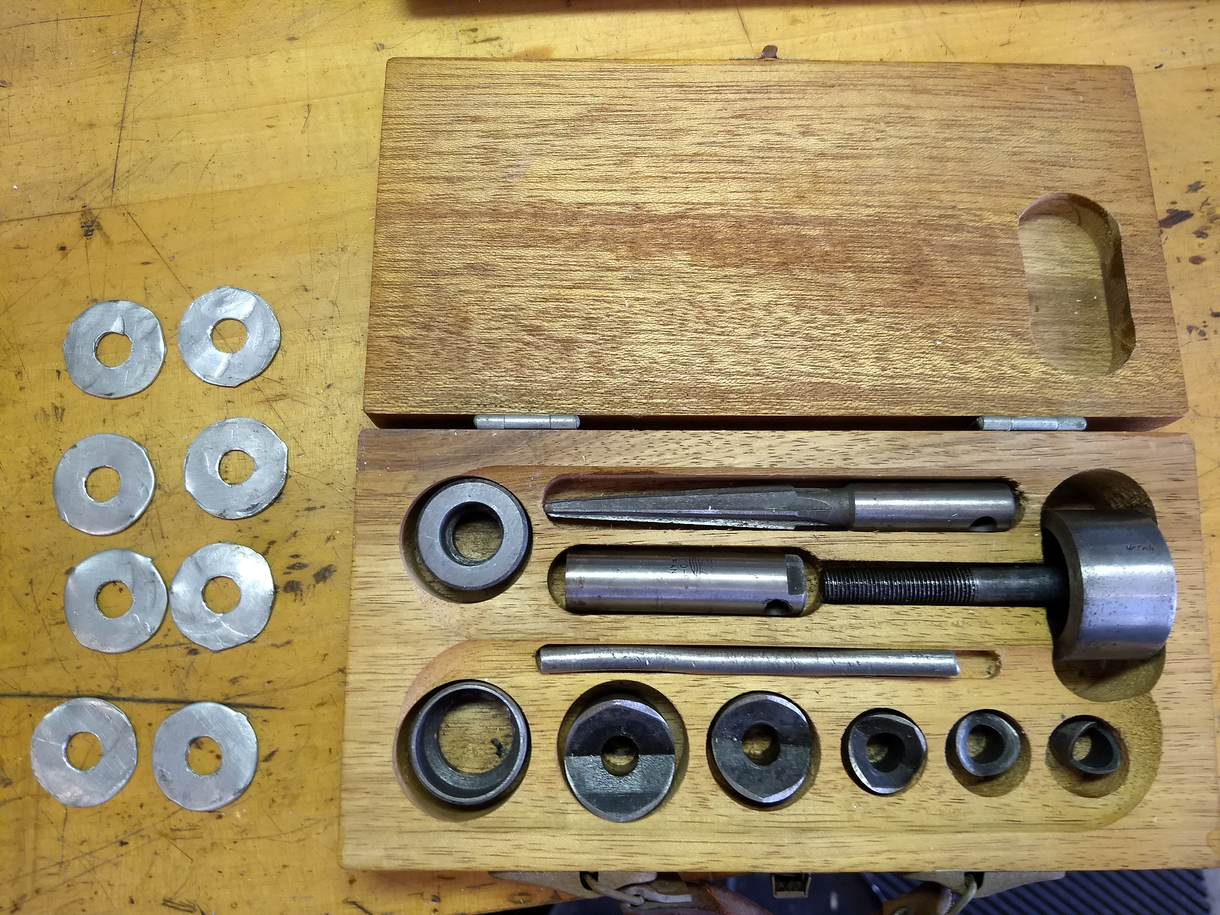

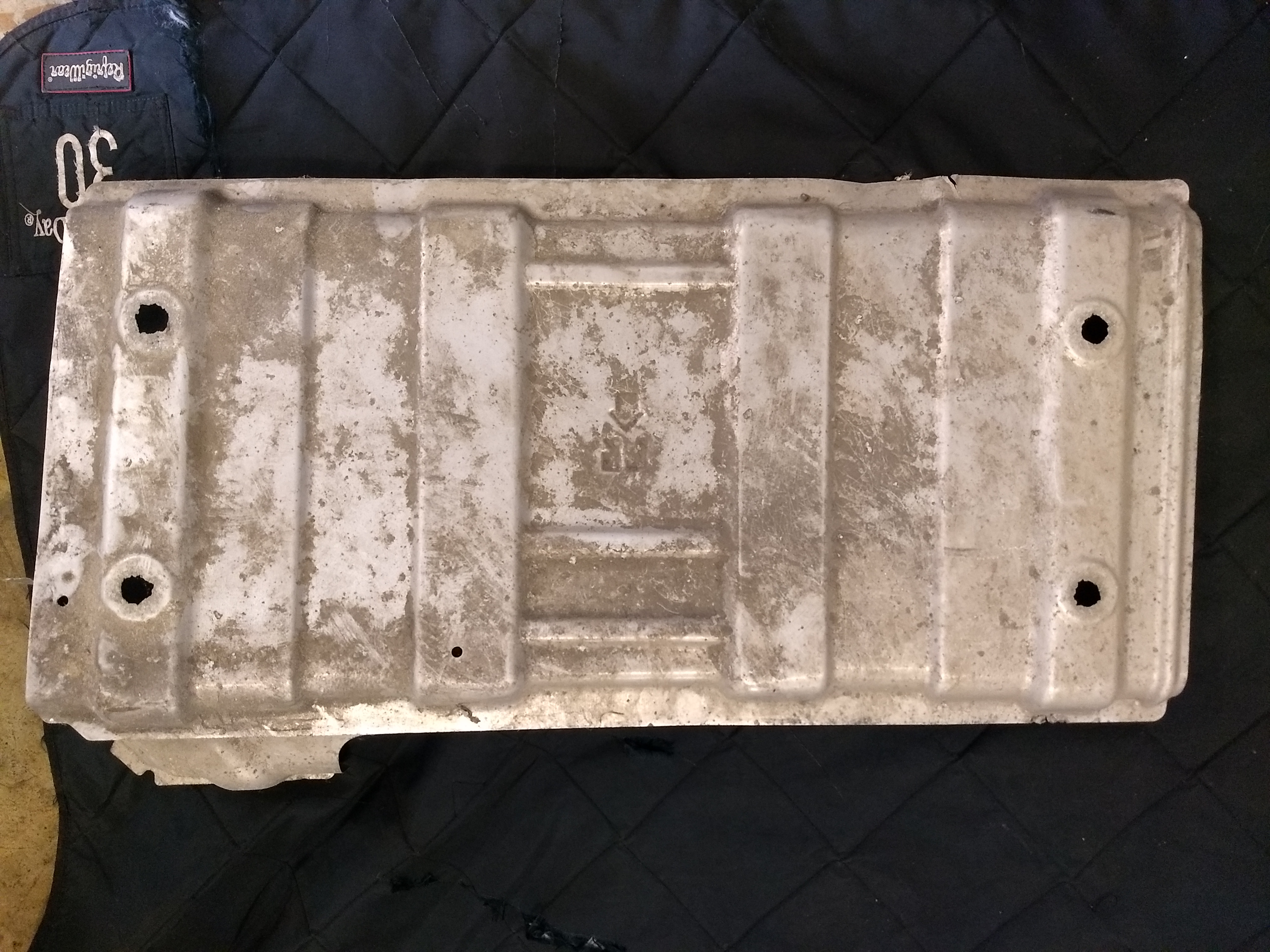

My Z will never be a car show winner, but I'm trying to take care of some little items here and there. Today's accomplishment was to reattach the heat shield that sits above the rear muffler. The old one had corroded through at the attachment points (due to galvanic corrosion), so I used a method to reattach it that I successfully used on our minivan some years back. I punched oversize aluminum washers to use above and below the mounting holes of the heatshield, and coated everything with anti-seize.
I always get a kick out of being able to use my dad's old tools to complete a repair. Here I was able to use an old metal punch set that he had to create the washers. This tool has to be 50 years old.
Here is the heatshield with the corroded-out mounting holes.

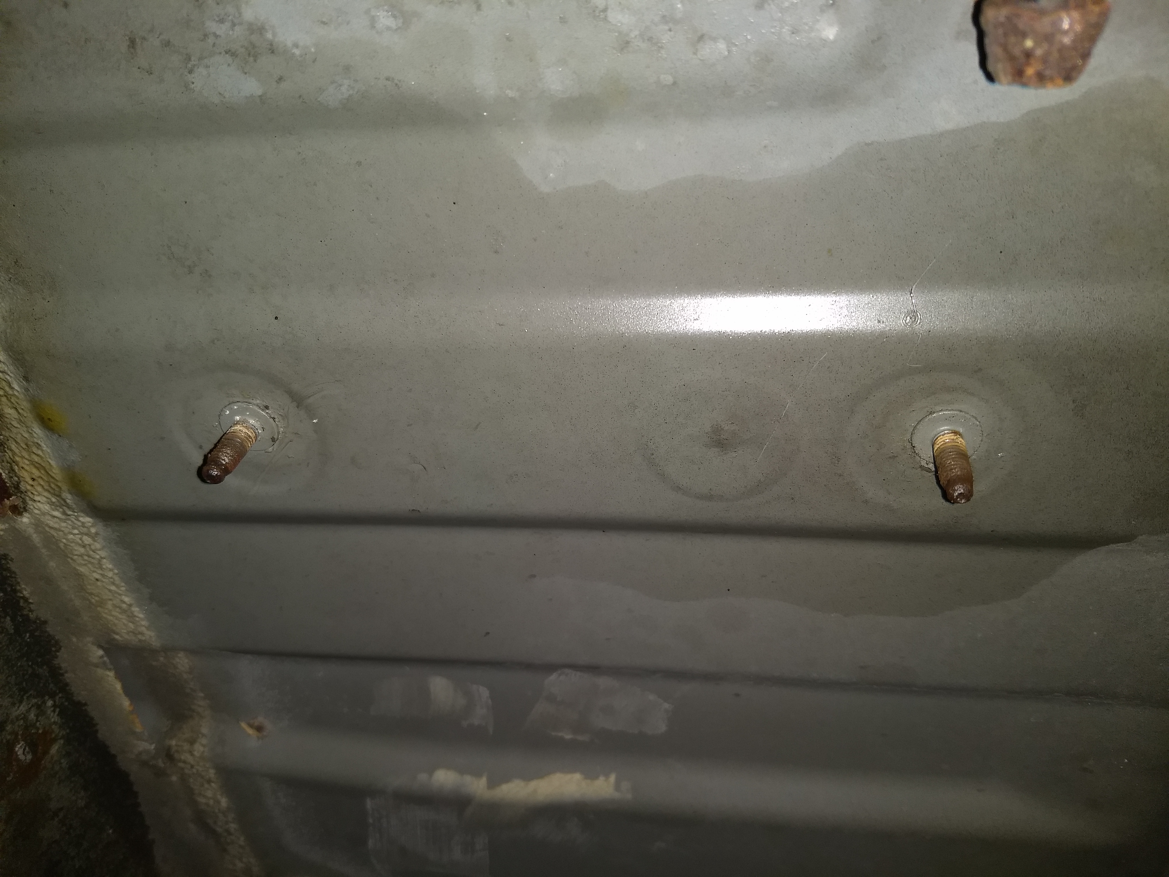

The antiseize was coated on the mounting studs, as well as both sides of the aluminum washers. Again, I put one washer on the body-side of the heatshield, and another on the underside. The anti-seize is not on the studs, yet, in this picture.

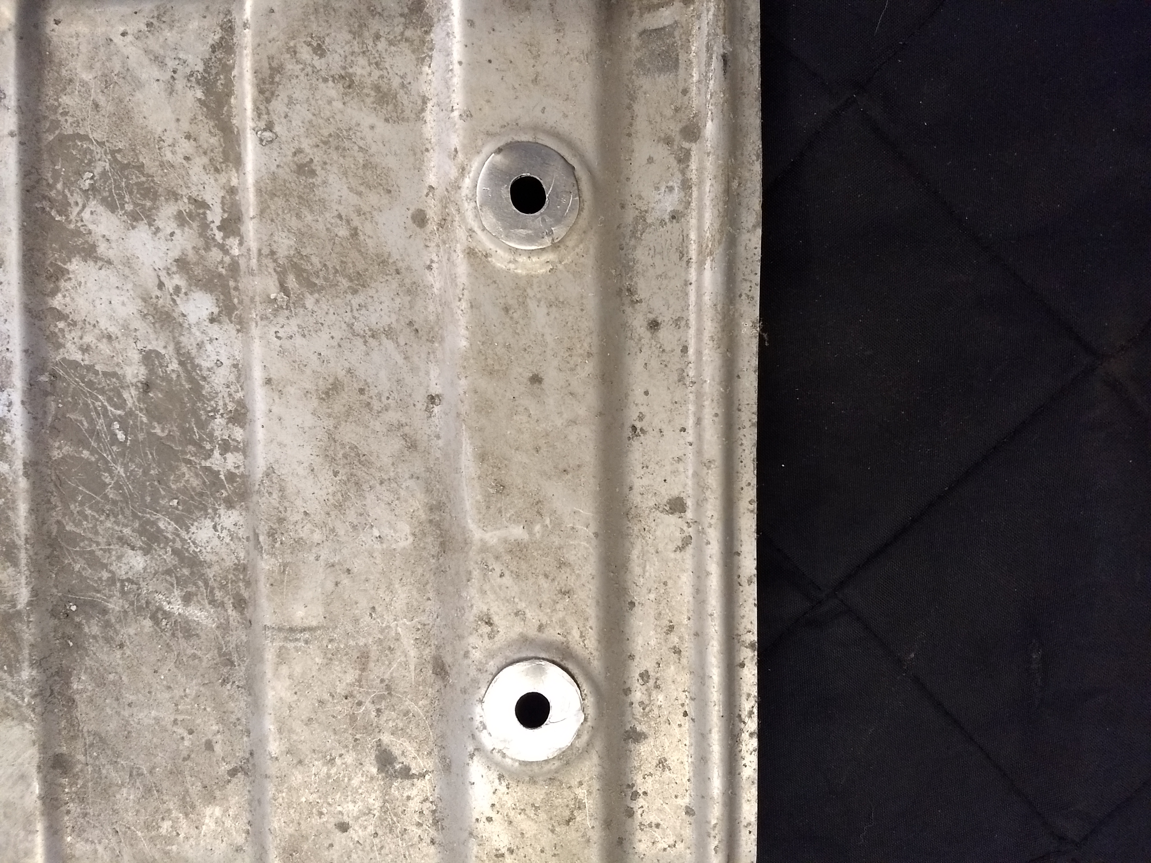

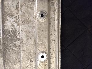

Here are the washers shown in place over a couple of the mounting holes.

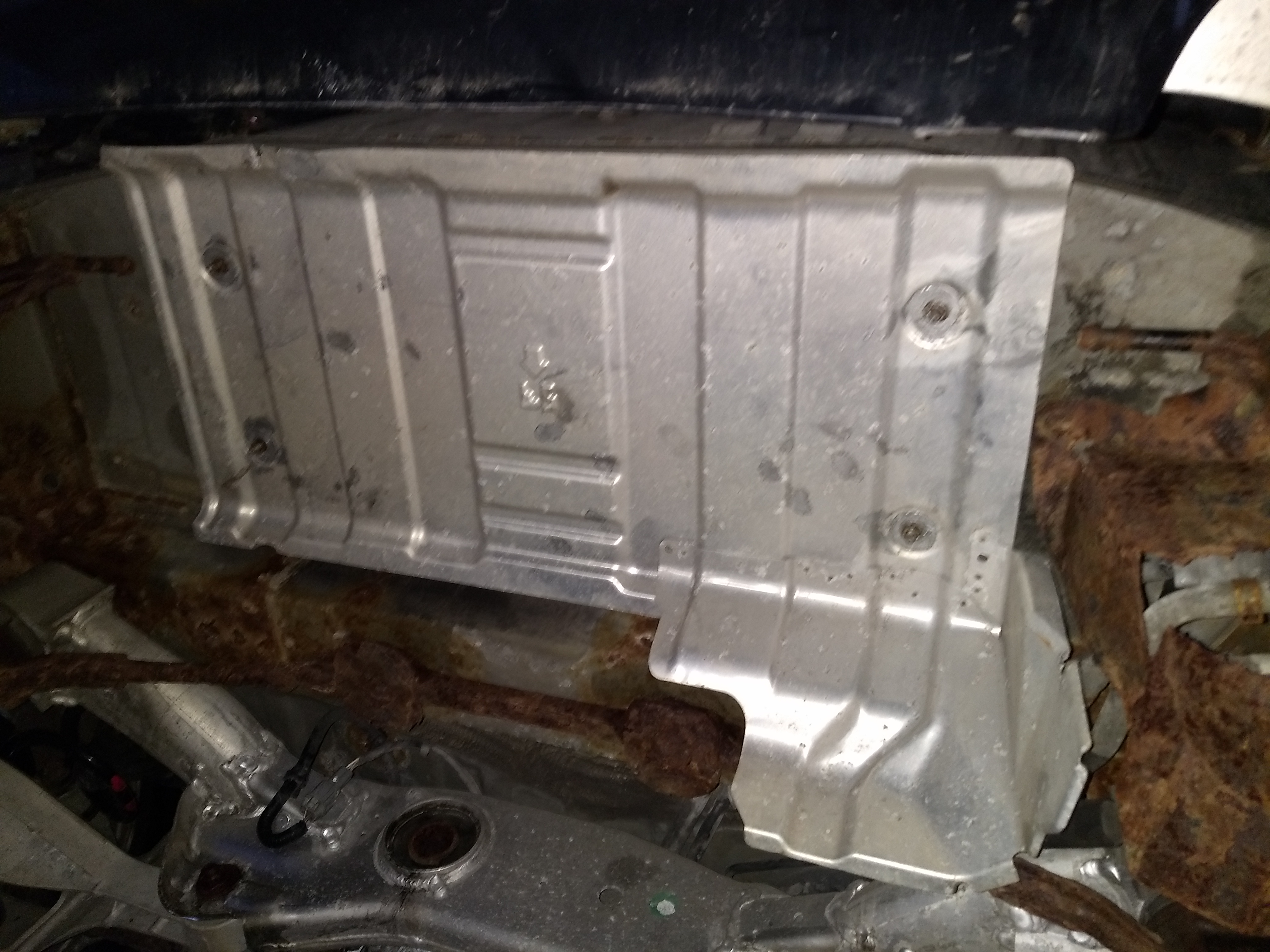

And then the heatshield was installed.

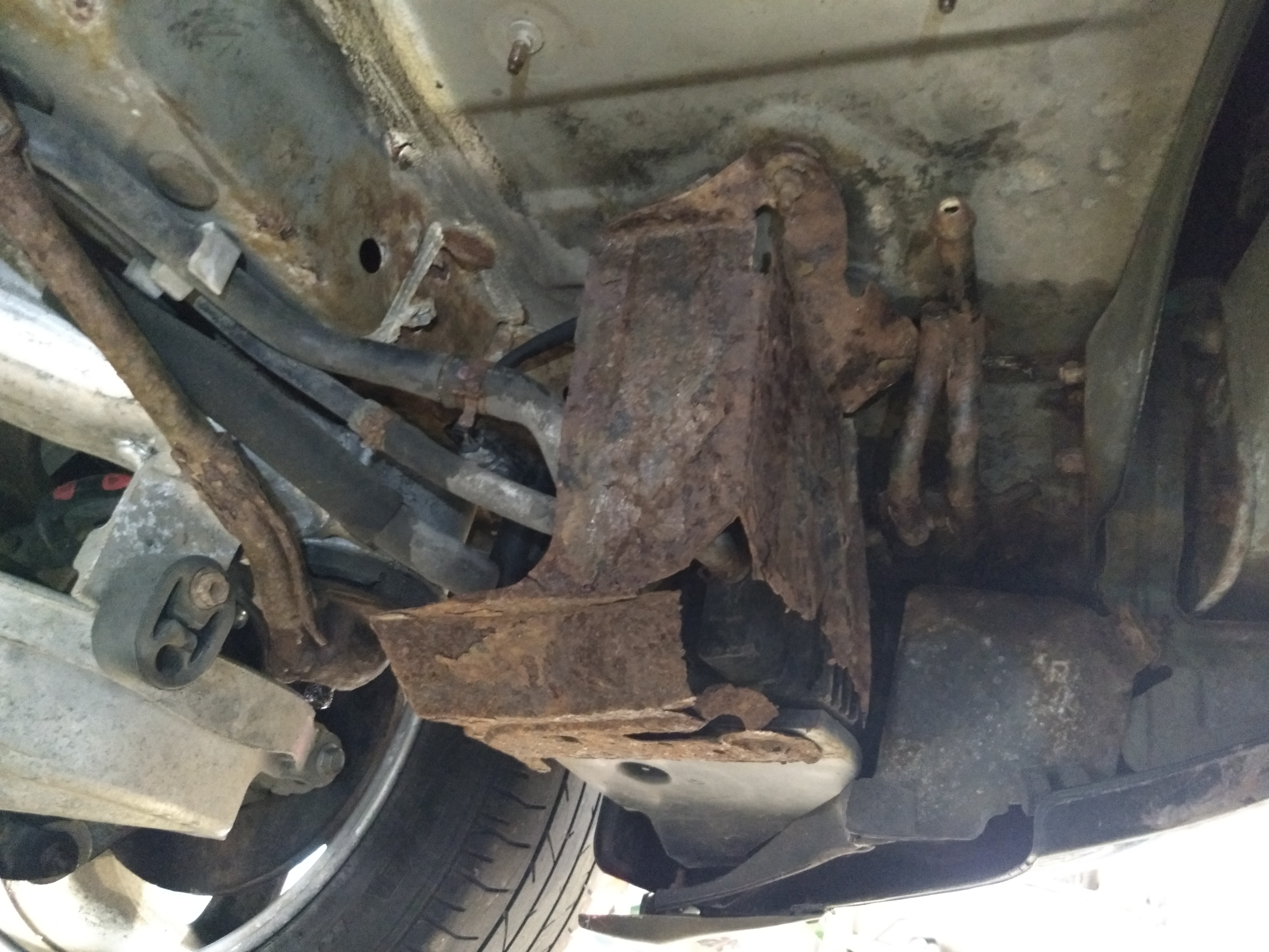

BTW, it looks like I'll need to replace the splashshield in this back corner. Anyone have one available?

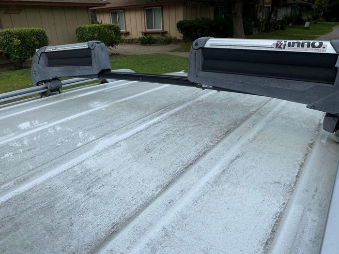

SInce the car was sitting in the shade - and I was shamed because my wife's car got a full polish and detail yesterday.... I washed it. First time since before COVID-19 and SIP.
Not worth pictures.
But wife's car OTOH, the roof yesterday 7am (car wash thingies don't clean the roof so good due to the year 'round ski racks.) My Z was this dirty but not stained like this at least.
4 hours, 3-stage polish (whole car), hand rubbed wax. Happy.
This SIP stuff does strange things to people. Made me do the above. And I only promised her I'd do it.... a year ago!

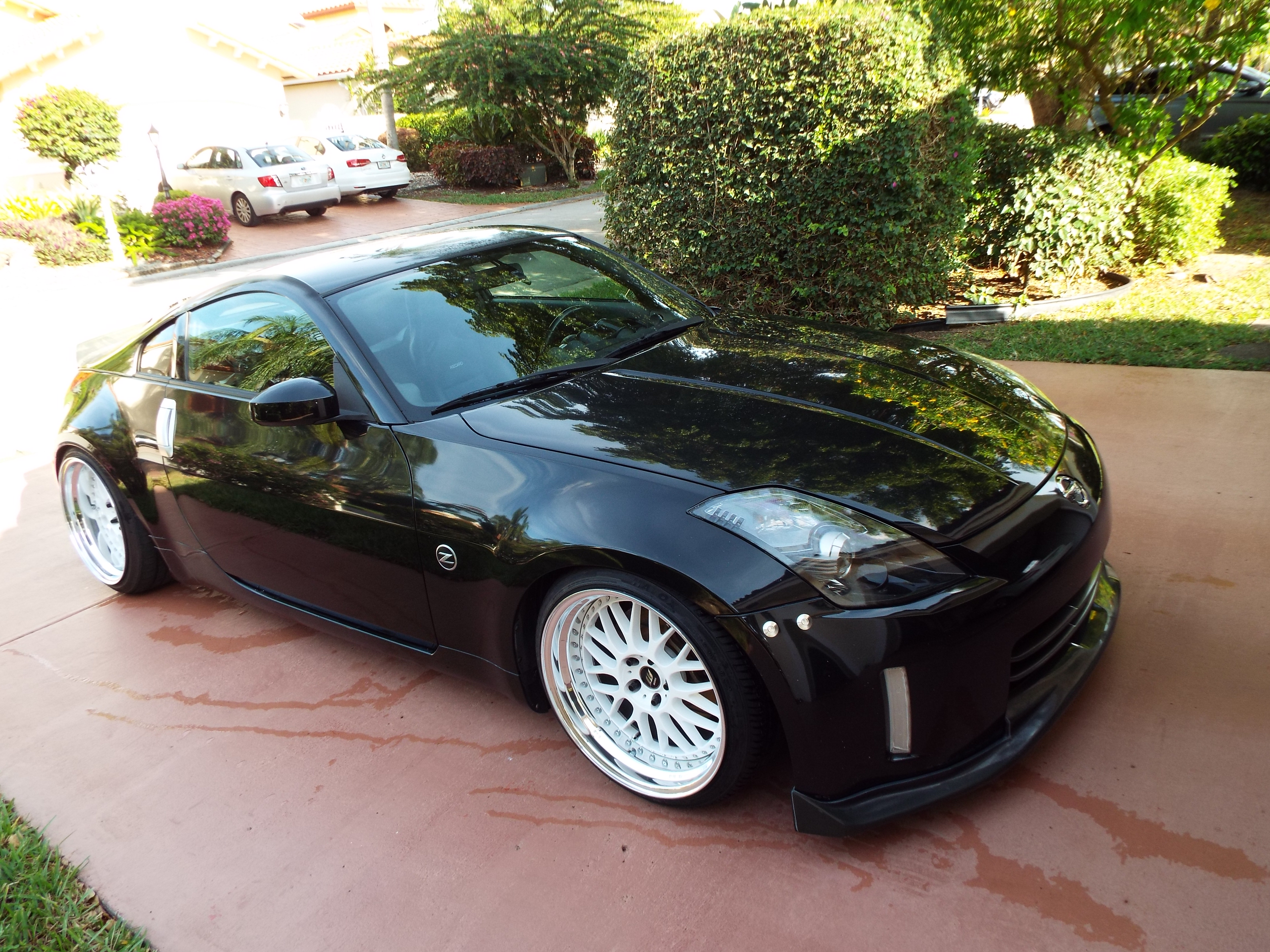

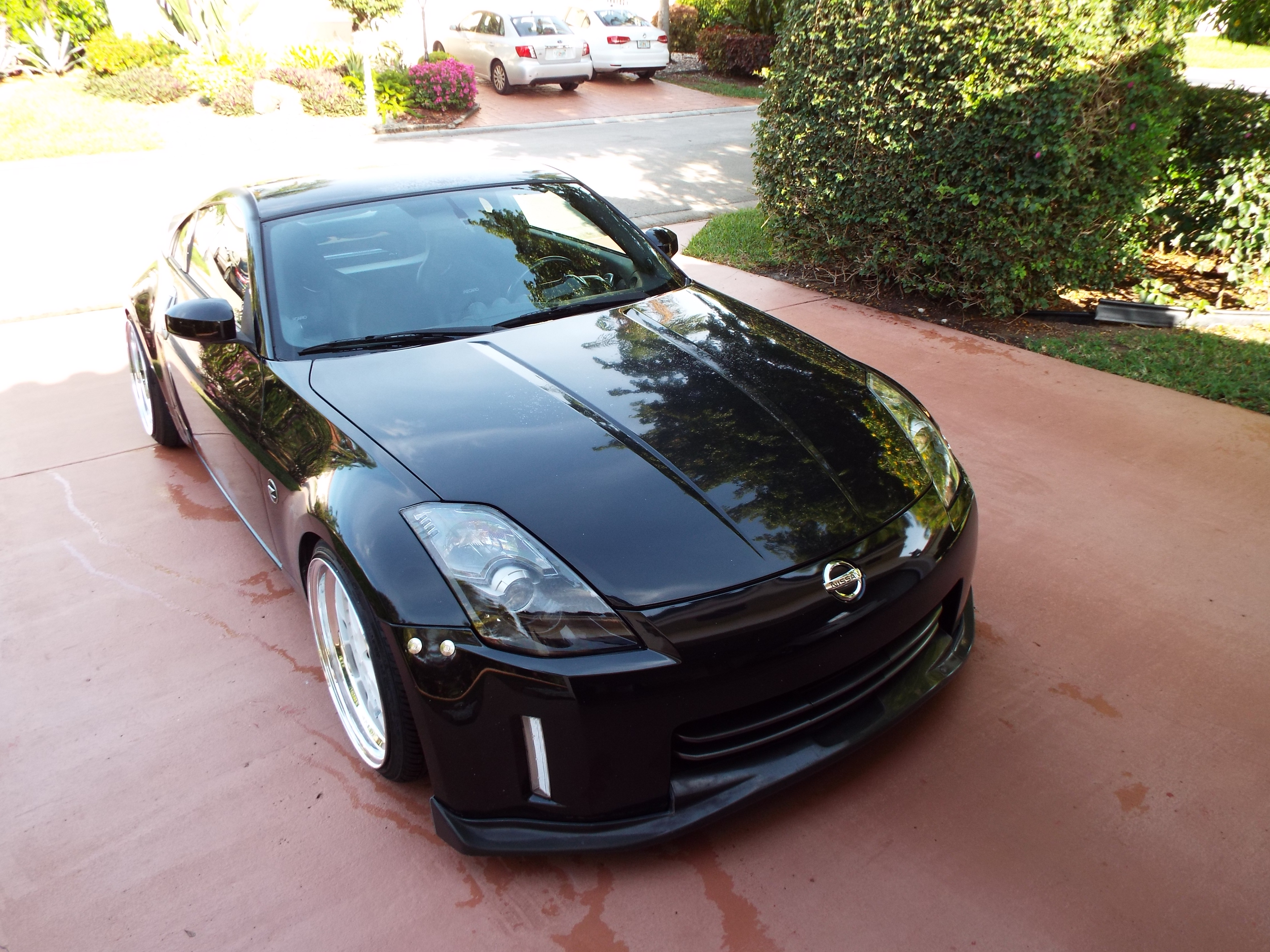

New Wheels
