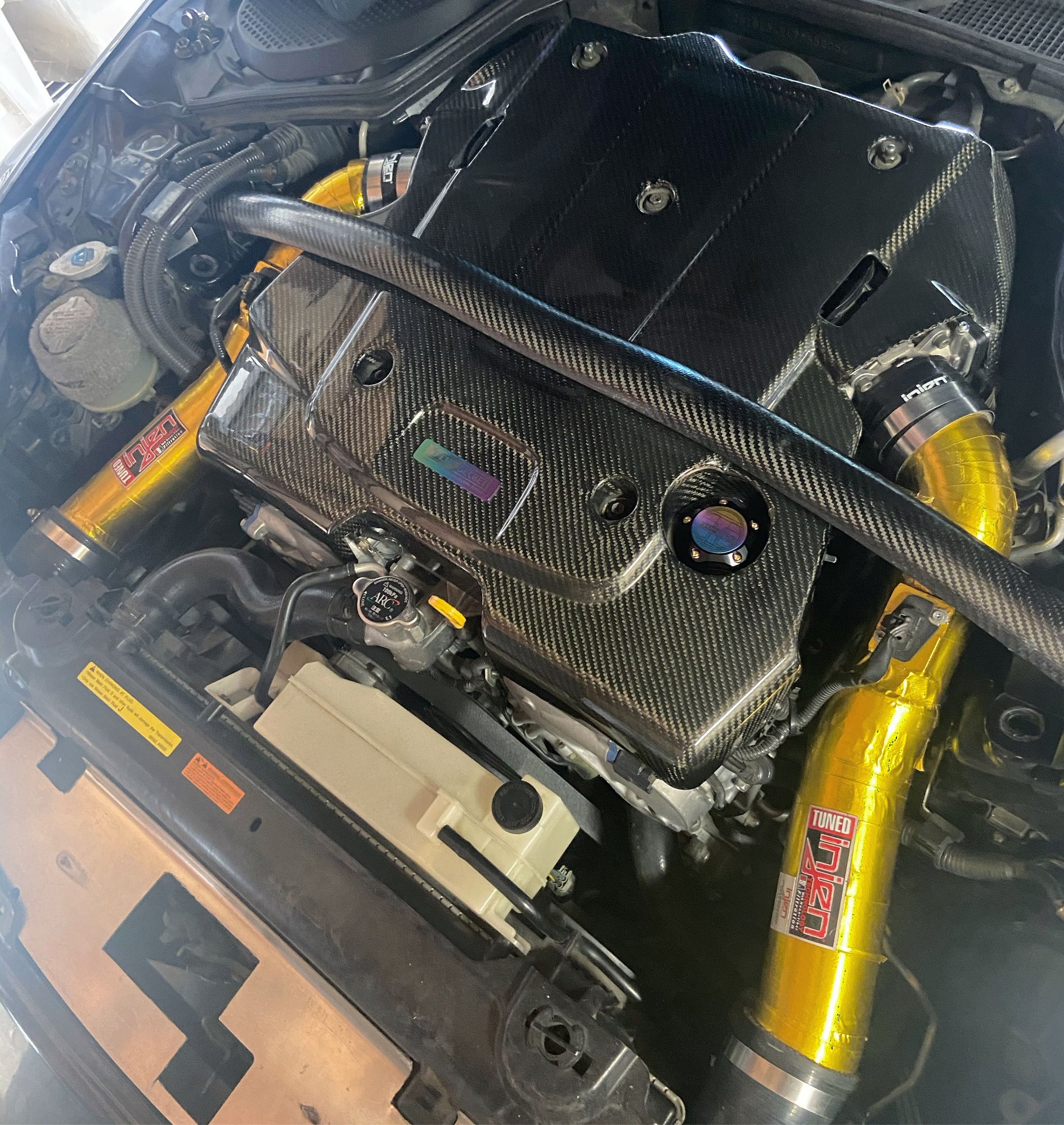

Installed my titanium hood prop yesterday, ignore the dirty engine bay lol.

Hold up, is that a Carbing strut bar??

Yes, there's a reason I've been recommending it to you!

only worried about fitment. I’m still bummed that I can’t run with the GT spec carbon fiber bar since it slopes downward for the DE. I need crazy thick spacers.

From what I saw everyone said the clearance was close to stock on the Carbing

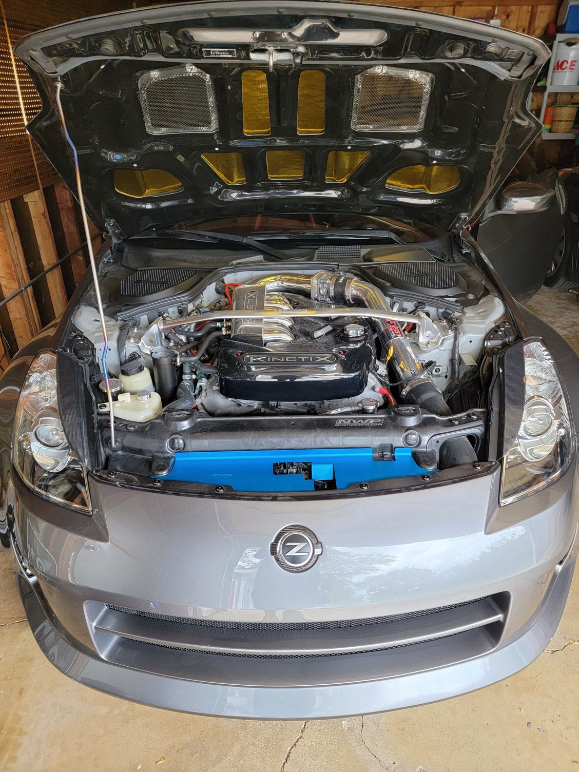

I took a bunch of pics so I can work on making my engine more presentable and clean up some wiring in fall/winter. Ordered a DEI master harness kit for the project.

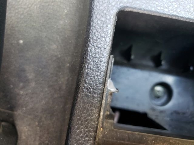

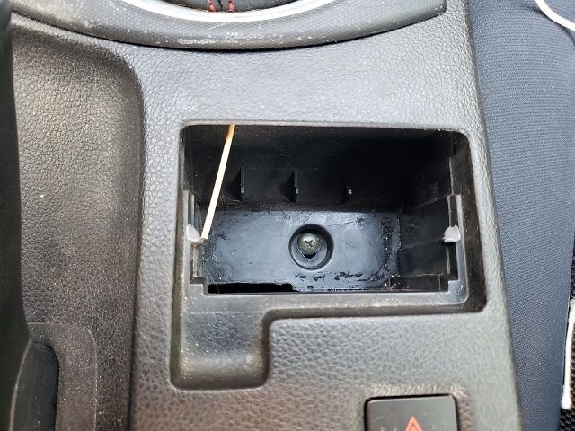

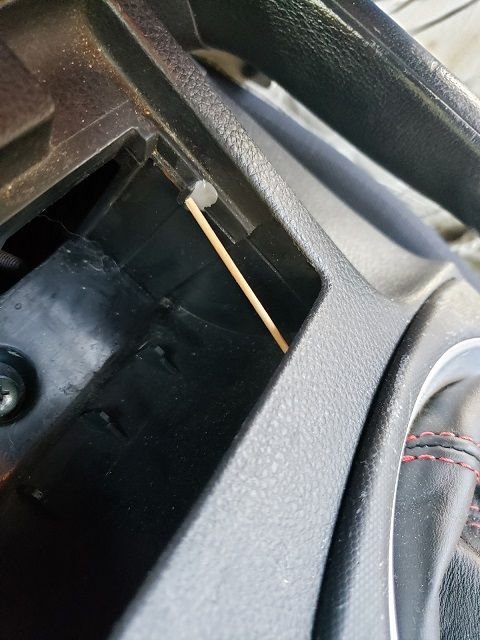

Default Repaired the loose ashtray/cointray
I finally got around to fixing the loose ashtray/cointray in the Z today. One of the guiding tabs (the one on the left/driver side) had cracked, so the cointray would shift around - especially when opening or closing the door. I used just a little bit of JB Weld to strengthen that tab and positioned a toothpick - cut to length and wedged in place - to hold the tab while the epoxy cured. I also put some epoxy in the same corner on the right/passenger side tab, since I figured it was just a matter of time before that tab would let go.
The toothpick was wedged in place to hold the cracked tab until the JB Weld cured.
Another view of the toothpick propping the tab in place.
Here is an overhead view of the dab of epoxy in that corner. t doesn't interfere with inserting the cointray or with the movement of its cover.

I don't race personally but I have noticed my temps getting higher than I'd like since the install of my headers. It's not uncommon for me to see ECTs north of 220 degrees in the summer here while stopped at a light or something.
All of that with the Varis cooling hood, I did notice that the Kinetix engine cover blocked a lot of the area between the fans and the vents so it's now been removed
