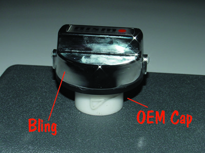

Here is the link to the cap at Courtesy Parts
The cap fits over the top of the OEM gas cap, you know, the one that came with the car.
Sweaty - It is chrome. The nozzle on the gas pump is aluminum, no safety concern.
lowrider - Exactly the same thing I said to Richard at Courtesy Parts right before I said "ship it". It's $50 worth of bling plain and simple.
ajk4 - sorry for the bad image. it's night in my garage.

can't seem to get the imge to post. let's try again.
can't seem to make the image upload tonight. tried 2 different computers so it's not on my end.
I'll try again in the morning.

OK, I am going to try to post this picture from work. Hopefully this will work.
OK, the site is messed up again. 3 different computers 2 different locations. Go figure. Sorry I can not post the image.
I'll let Victor know.

Last try...

That should make it go even faster..............
Old Jan 14, 2004 | 04:44 PM
Reggi914's Avatar
Reggi914
Posts: 10,647
From: NY
Its nice, i like it.
